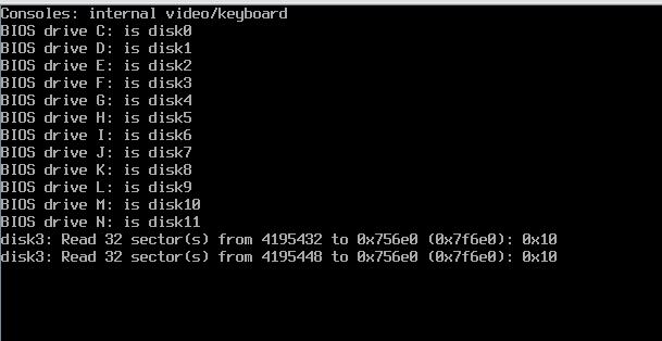

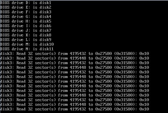

My truenas will take about 30 minutes to display this interface when it is newly installed or restarted. It can be used normally after startup!
My hardware
TrueNAS-13.0-RELEASE
Main board: s1200spl
Hard disk: Kingston SSD +hba
The startup mode UEFI and BIOS have been tried!

This problem occurred suddenly after upgrading the version of 11.2u7. After searching the forum, it seems that it is a gptzfsboot boot problem. Does anyone know how to solve this problem?
Samuel Tai
Apr 24, 2020
5,399
This could be just slow drive enumeration through the HBA, and then searching for a boot drive within the array. How is your boot SSD connected? If PCI-E or directly to the motherboard, you can modify your BIOS boot settings not to search through the array, and only directly to your boot SSD. You could also try disabling any boot ROM on your HBA.
