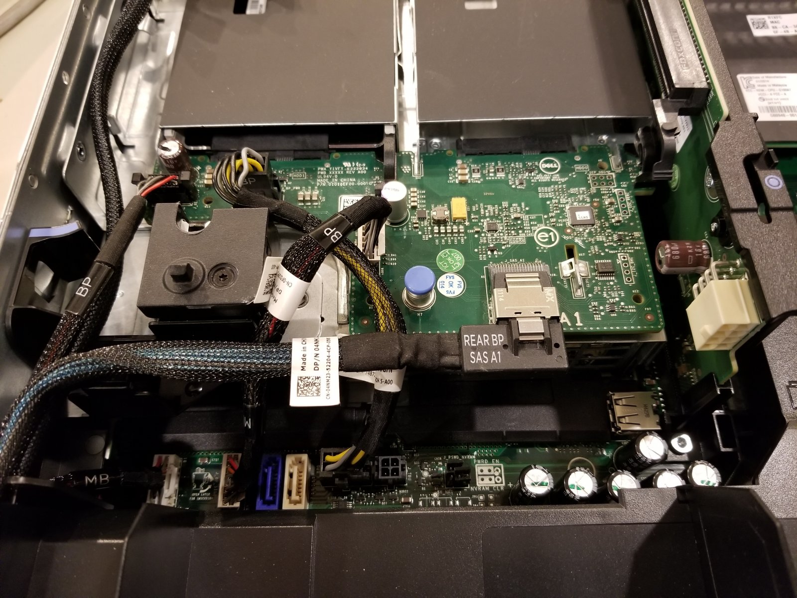

So upon further looking I do see that the circuit board that connected the two rear drives are attached to the H710 raid controller card. The raid controller that is now in IT mode. There are 2 sata connectors on the MB that I think are for the other models of this server that have the front facing cdrom drive. I cant access those since the boot drive is plugged in to the 2.5inch rear facing caddie which are connected via the custom controller board for those two rear facing caddies. See the photo. So the bottom line is that I have everything plugged into the raid controller essentially. With it in IT mode I cant find a screen that even sees a any of the disks. Im guessing the Truenas installed has a driver to access the IT mode H710 to see the disks and install to one of them. Any idea how I get the mother board to see these drives at this point? There appears to be no other sata connector for the custom pcb that goes into the rear facing drive bays.

Yeah, you'll want to use a standard sata and sata power to power up that SSD, you don't want it connected to the HBA.

Yeah I have been thinking about this over night and I think your right. Im guessing that my reflashing of the raid controller to IT mode essentially hid the drives on the back plane from the bios. So what Im thinking of doing is getting a pci to M2 2280 type of card and add a m.2 like drive to the machine. I think this will be a cleaner installation and dont have to try and mount the drive in the machine in a weird way non standard way.

This particular version of the R720 has no cdrom. 12 front facing 3.5in drives. There are cables that come up off the MB to the rear backplane. There is of course no documentation on what those do. But yeah I agree there should be 5 volts available somewhere.
FYI on the 720XD the sata ports are disabled, I sorta learned that after i got my 720XD can could not for the life of me figure out why the drive would not show up

So I have tried the adapter and the SSD. Both slots failed. When in the PCIe slot in riser 3 the machine give me a PCIe Error warning and halts the system. Im guessing the bios does not like the ssd or something. I then move the ssd to the other slot and plugged into the Sata that went into the MB. This also failed, as RonClark said the sata are disabled. This is annoying. So to the best of everyone knowledge is there a way to turn on the sata interfaces? Maybe a jumper or bios setting somewhere?
