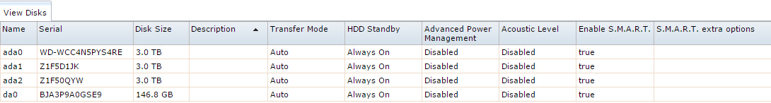

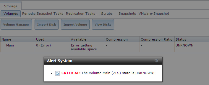

I replaced a failed drive and now getting the error:
CRITICAL: The volume Main (ZFS) state is UNKNOWN:
Although I did changed the failed drive to OFFLINE before shutting down the system.

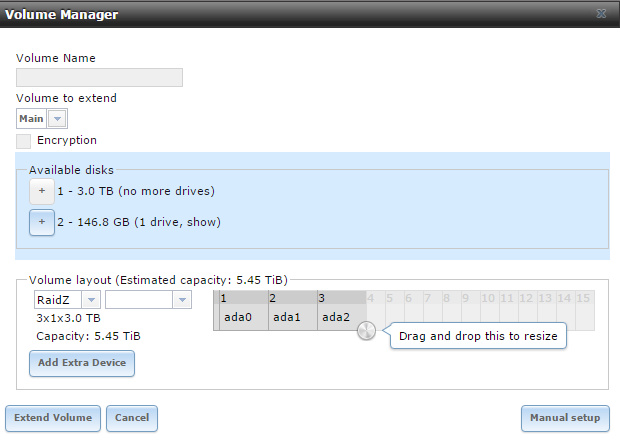

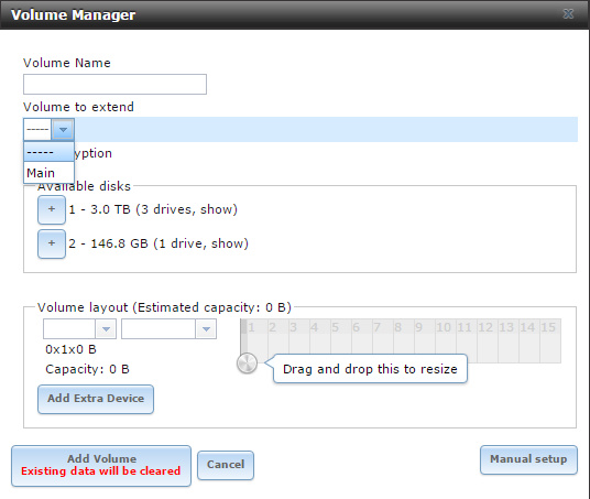

Volume "Main" appears only when I try to extend a volume
When trying to add a drive, I can see that 3 drives her... I just canceled, done nothing
I did not attempt writing any data to the volume since it became degraded, and was functioning in a normal way just before switching off the server.

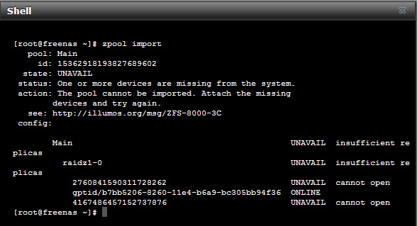

It appears you suffered a second disk failure after shutdown. With 2 out of 3 drives
failed, you appear to have lost your pool.

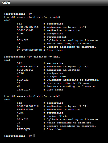

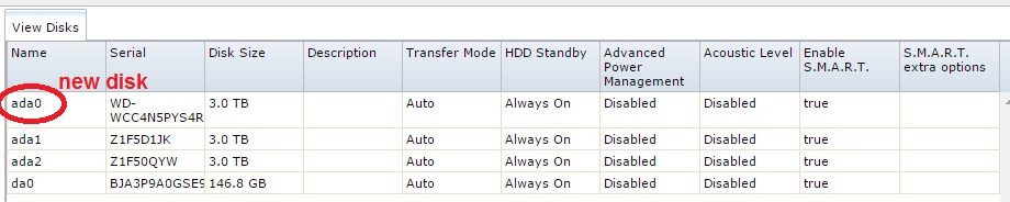

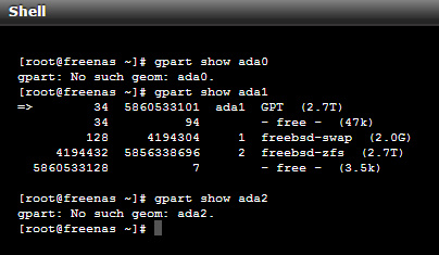

Here are the outputs from the commands provided. ada0 is my new disk, ada1 and ada2 are the old ones which are good.
Have some questions here:
- gpart is not showing anything for my ada0. Is that because it is the new one?
- gpart is not showing anything for my ada2, while it should be a good disk, why is that?
What proves that the removed disk is really the bad one is that I was still able to read my files after taking it OFFLINE, for example I tried to play a movie.

For the ada0 disk, if it's the new, replacement disk, then yes, lack of a partition table is normal.
The ada1 disk's partition table seems to be perfectly normal for FreeNAS.
If you are certain disk ada2 is the other good disk, and was the one you put into MS-Windows
machine, then either MS-Windows seems to have done something to it. Or the USB adapter.
What it did, I would not beable to tell remotely.
But, the lack of partition table indicates that either the disk has been over-written, or perhaps just
it's partition table.
My skills with Unix in general is quite good. And very good for Solaris & Linux. But, FreeBSD,
(used by FreeNAS), not so much. So I can't walk you though a potential fix. Sorry. Perhap some
one else can help further with the information you have supplied.
