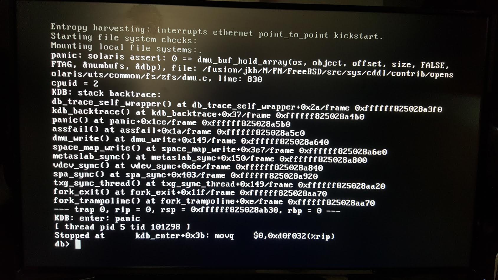

Now getting a critical error,
When I try to check in Storage:
Data1 0 (Error) Error getting available space - - UNKNOWN
I have no option to view the Volume status.
When I select the View Volume, the only option I get at the bottom of the screen is to "Detach Volume".
Is this a swapping error and I need to go back and take the original drive offline somehow first?

Damn it. Woke up this morning. Resilvering complete with 32 errors.
"Critical error One or more devices has experienced an error resulting in data corruption. Applications may be affected"
Argh, now what?

zpool status seems to show a problem with my Plex Media Server files along with a few others?
[root@freenas ~]# zpool status -v
  pool: CVZData1
state: ONLINE
		corruption.  Applications may be affected.
action: Restore the file in question if possible.  Otherwise restore the
		entire pool from backup.
   see: http://illumos.org/msg/ZFS-8000-8A
  scan: resilvered 1.99T in 7h56m with 32 errors on Sun Mar 12 20:09:58 2017
config:
		NAME											STATE	 READ WRITE CKSUM
		CVZData1										ONLINE	   0	 0 3.47K
		  mirror-0									  ONLINE	   0	 0 13.9K
			gptid/22db21f3-06fb-11e7-adcf-94de8001cf84  ONLINE	   0	 0 13.9K
			gptid/52f9fa22-d0a8-11e4-a7a0-94de8001cf84  ONLINE	   0	 0 13.9K
		<metadata>:<0x122>
		<metadata>:<0x123>
		<metadata>:<0x124>
		<metadata>:<0x15a>
		<metadata>:<0x64>
		<metadata>:<0x6a>
		CVZData1/jails_2/plexmediaserver_1:<0x0>
		/mnt/CVZData1/jails_2/plexmediaserver_1/var/db/plexdata/Plex Media Server/Logs/Plex Media Server.log
		/var/db/system/freenas.local-2017-03-10-1.db
		/var/db/system/freenas.local-2017-03-10-2.db
		/var/db/system/freenas.local-2017-03-10-3.db
		/var/db/system/syslog-f36704f2fe794cb6a75657843255655d/log/nginx-error.log
		/var/db/system/cores/devd.core
		/var/db/system/cores/python2.7.core
		CVZData1/PLEXMedia:<0x0>

Now what?
SweetAndLow
Sweet'NASty
Nov 6, 2013
6,421
You have data loss in your pool from not having proper data protection at some point. Sometimes you can remove those files but since you have done metadata corruption you are going to have to rebuild your pool. Copy as much of as possible.

New problem though.
OS won't boot up completely.
Stops at the same point each time.
Does this mean anything:
SweetAndLow
Sweet'NASty
Nov 6, 2013
6,421
Your boot device is probably dead. Time to replace it. Hope you backed up your config file and/or encryption keys.
Jun 26, 2012
260
Wow. Batting 1.000 this week.
Sheesh.
Jun 26, 2012
260
And, I do have a backup of the config. Thankfully.
