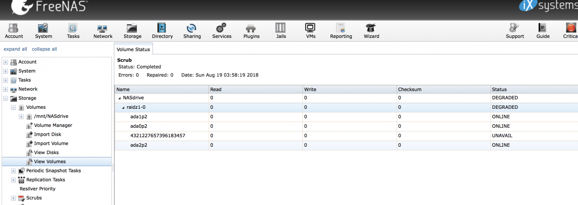

Post output for zpool status
PDizzz
Aug 29, 2018
20

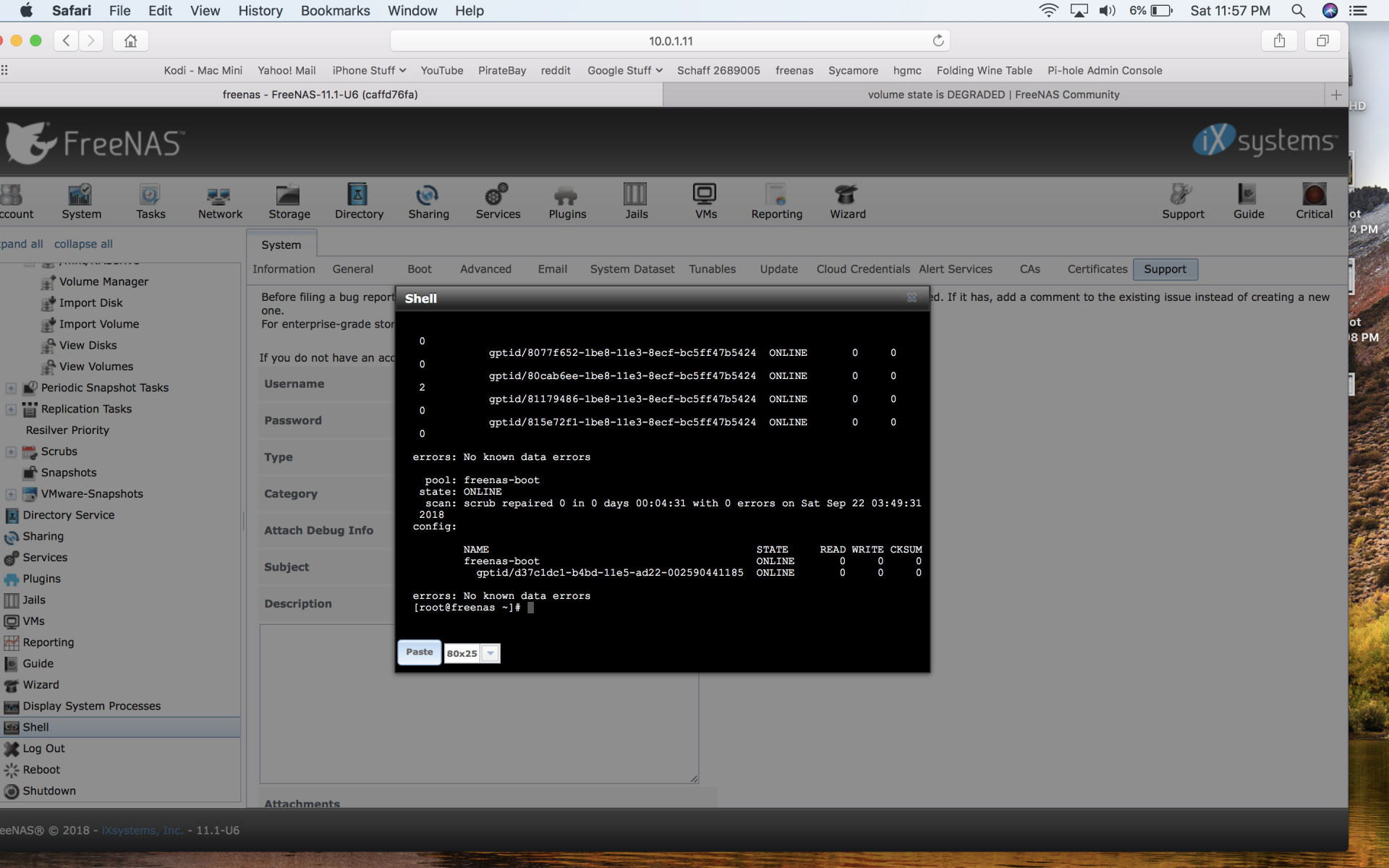

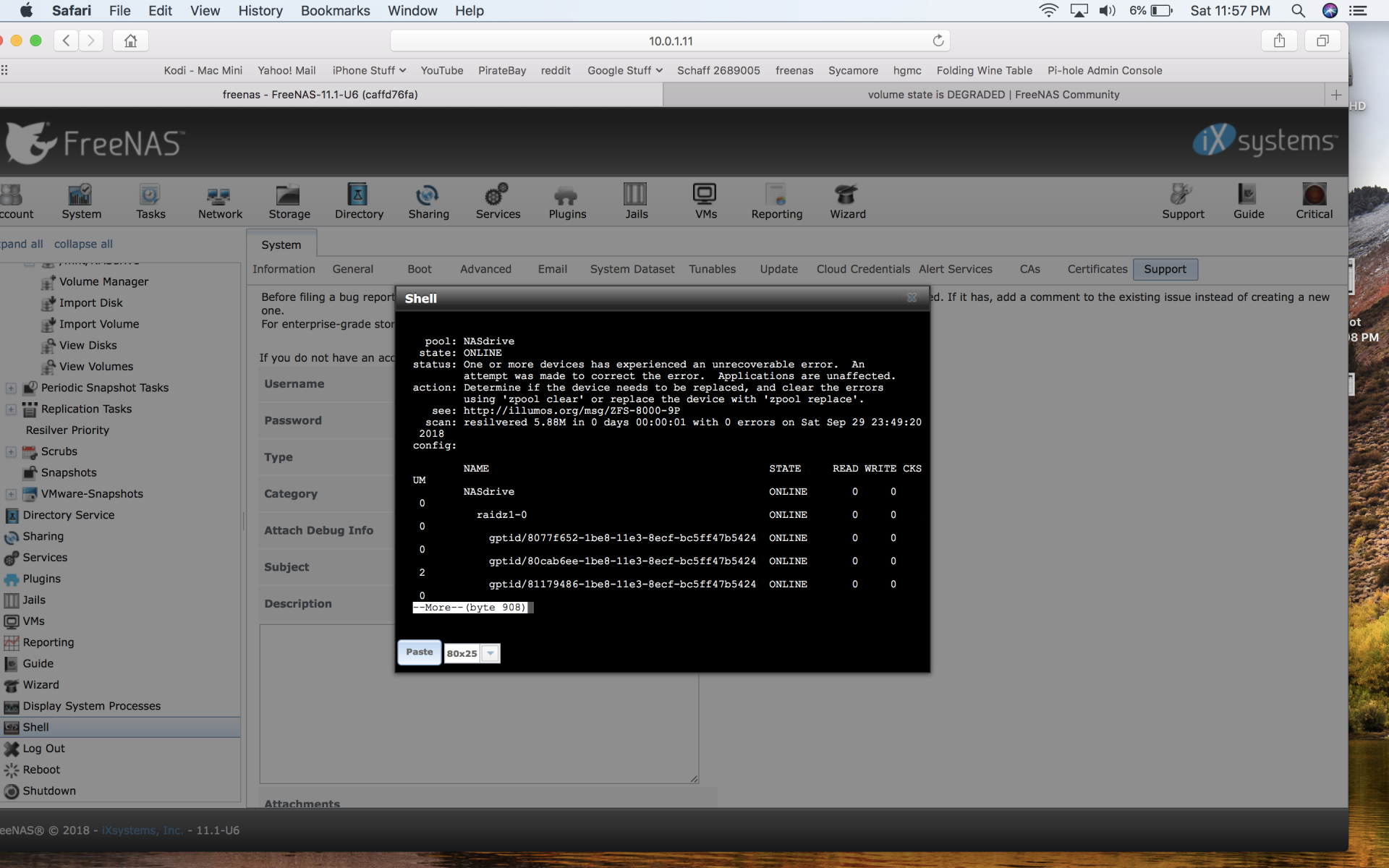

I reseated all the cables and powered back up, and now the critical message has changed. "The volume ******** state is ONLINE: One or more devices has experienced an unrecoverable error. An attempt was made to correct the error. Applications are unaffected." I've attached screenshots of the shell showing pool status.
15,504
Scrub your pool (and there isn't the least reason to mask its name, especially since you showed it in your screenshots). Run zpool scrub NASdrive at the shell, and wait for it to complete.

I ran that command, and there is no apparent change. Can you tell me what I should do next?
15,504
Wait for it to finish. You can check the progress using the Volume Status page in the GUI or using zpool status at the shell. If you have email properly set up, you should get an email notification when it finishes.
PDizzz
Aug 29, 2018
20
Again, thank you for your time. I'm so green at this, it's a miracle this thing worked at all when I built it.
The screen shot is my current zpool status. What now?
Stux
Jun 2, 2016
4,419
You’re fine. Congrats
