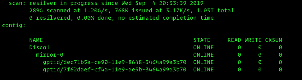

@Ericloewe I tried following this tutorial, but I had a lot of problems with my iocages. They do not start properly. The biggest problem is with my GitLab and Nextcloud, I have a lot of information and configurations in it and I can't lose them. But my VM machine works fine. I reverted to the "old" disk.
Possible solution: I will try again.
EDIT: So,... finally the tutorial works for me.
Now, I need to confirm the replication is ok... How I test this? Can I get one confirmation of this result via GUI or CLI? how I check if it’s all ok?
(image attached)
Thanks @danb35 for your help here and the previous thread and @Ericloewe for your knowlegment and help.

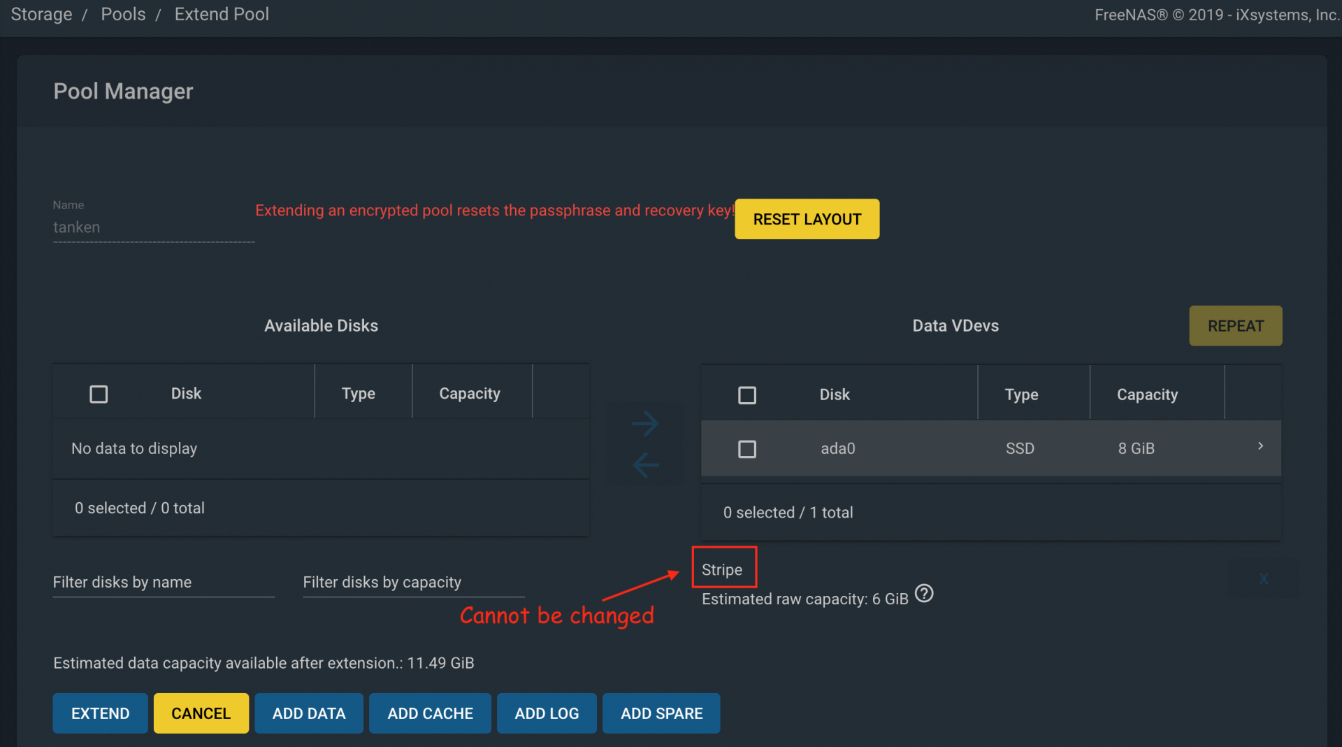

@Ericloewe if I am guessing right, this is your original feature request which would (among other things) allow for converting a stripe to a mirror by adding a disk in the GUI:
It is now closed and it looks as it is included in the upcoming 11.3 release:
However, I just tried if I could add a disk to a stripe and convert it to a mirror in the GUI on a FreeNAS-11.3-RC1 test installation in a VM, but apparently it is not possible (or I have overlooked something).
(I cannot add a comment to the feature request, so therefore I write here.)

@Ericloewe …and BTW, the method I described previously in this post no longer works in 11.3. So currently there is no way to transform a single-disk encrypted vdev into a mirrored vdev by adding a disk. So if you need to do that you would have to invest in two new drives instead of only one in order to create a new encrypted and mirrored pool, then copy all data over and discard/export the existing pool.
The step that fails in my previously described procedure is getting rid of the fake pool in FreeNAS's configuration. In 11.3 (and maybe also 11.2 but untested) you end up with a pool where the disk is offline and you cannot delete the pool from the GUI. If you try, you get this error and stack trace:

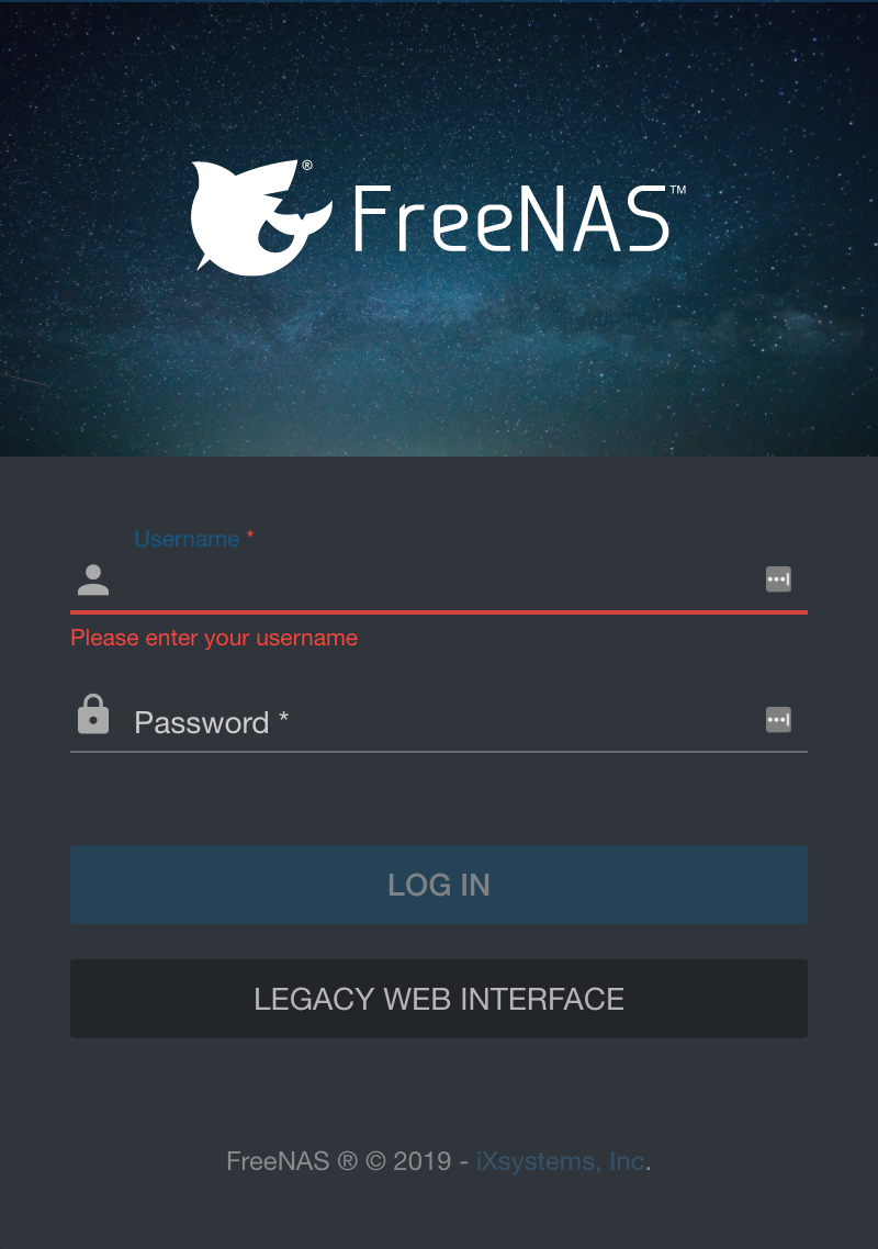

As an aside, the new GUI is limiting: neither does it allow things to be done, nor does it let you fix things in CLI without then getting stroppy about the results. The whole reason I am here is because I was too eager and trusted the new GUI. :( My bad.
As a last resort, you could try switching back to the old GUI in 11.3. On the login page you can click “LEGACY WEB INTERFACE”. Maybe, the workaround will work there, but I haven't tried, so test it out in a VM before risking you real storage pool.
