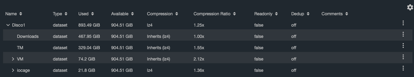

Yes, @danb35 is right. In the end of the tutorial (via CLI) I had this output:This may be true (though I haven't yet seen any), but @stlkr's issue has nothing whatsoever to do with the new UI.
So... what is my best chance to fix my problem? Backup all information and configure all again?...and to that issue, I'm not sure if having removed the disk from the pool (as you did here) should affect anything--I don't remember hearing that it would, but vdev removal is pretty new at this point.
Perhaps not the GUI specifically, but the GUI and the new Middleware go hand-in-hand and were released at the same time and I have found a number of things that don't work the way they used to / should and (as far as I am concerned) that means they are broken. The root cause may even be in the underlying version of FreeBSD, but there are things that are just not working now.This may be true (though I haven't yet seen any), but @stlkr's issue has nothing whatsoever to do with the new UI.
After reboot, I have a different output:This may be true (though I haven't yet seen any), but @stlkr's issue has nothing whatsoever to do with the new UI.
root@freenas[~]# zpool attach Disco1 /dev/dee51a10-6414-11e9-b71e-3464a99a3b70 /dev/gptid/a1f796ce-b62f-11e9-afc0-3464a99a3b70 cannot attach /dev/gptid/a1f796ce-b62f-11e9-afc0-3464a99a3b70 to /dev/dee51a10-6414-11e9-b71e-3464a99a3b70: no such device in pool
