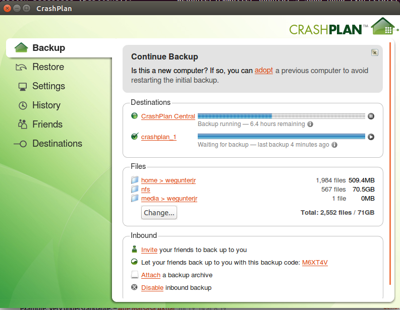

okay. this is where I might be losing the understanding. I am attaching a screenshot of my Crashplan GUI on the lInux machine that I have connected to the FreeNAS Crashplan plugin.
I don't need that.
What I am telling you is that you CANNOT backup your clients to your FREENAS Crashplan and have it backup those backups to the cloud. They DO NOT ALLOW that. Pick one or the other.

is it possible to do both? Or am I even doing one?
I see the linux machine data in the crashplan cloud, but not he crashplan_1 data.
  • Screenshot from 2016-01-04 20:47:12.png

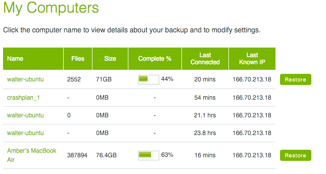

this is what my crashplan account shows:

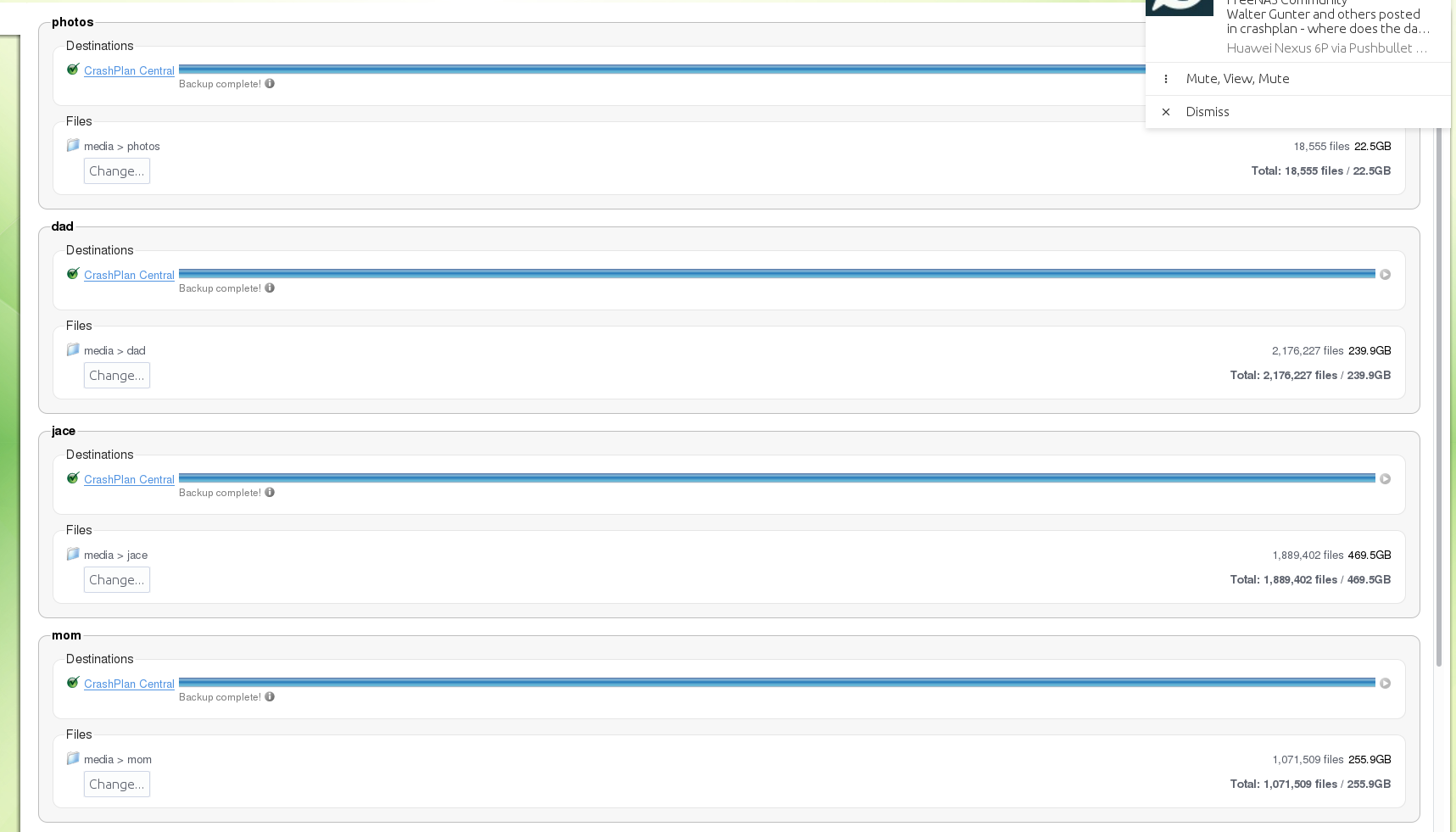

Here are a couple of screenshots from MY setup.
First up we have the datasets where I use RSYNC to backup my client machines profiles to.
Then we have my Crashplan backing up these datasets to their cloud.
