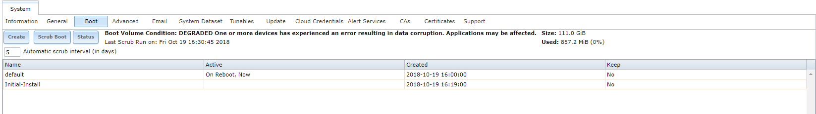

A few days ago I bought two sandisk 120 gb ssds as boot drives. I have a very similar system to this:
http://jro.io/nas/#build
Only difference is I use an intel s2600cp2j motherboard.

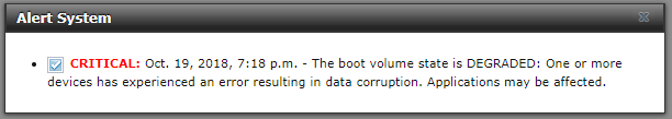

I install the sandisk ssds in, I reinstall freenas on them, everything goes smoothly, but upon loading up the webgui I get the critical error that the boot drive is degraded. So I think okay, one or both of the drives are corrupted or faulty. I replace both drives with brand new sandisk ssds. same thing. I reinstall freenas, still corrupted. I don't understand what to do now.
This is the link I get referenced to:
http://illumos.org/msg/ZFS-8000-8A
then I scrubed the boot drives and I got referred to this:
http://illumos.org/msg/ZFS-8000-9P
If anyone can help, is it something with sandisk SSDs? Is there something I'm doing wrong? I am a pretty savvy user and had no issues with booting from dual usb sticks.

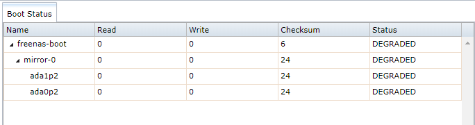

I didn't mean to not follow the rules. My apologies. I am running freenas11.1-U6 Stable, no beta or RC. This is the error I'm getting:
When I run zpool status:
  pool: freenas-boot
 state: DEGRADED
		corruption.  Applications may be affected.
action: Restore the file in question if possible.  Otherwise restore the
		entire pool from backup.
   see: http://illumos.org/msg/ZFS-8000-8A
  scan: scrub repaired 11K in 0 days 00:00:03 with 31 errors on Fri Oct 19 16:30:45 2018
config:
		NAME		STATE	 READ WRITE CKSUM
		freenas-boot  DEGRADED	 0	 0	 6
		  mirror-0  DEGRADED	 0	 0	24
			ada0p2  DEGRADED	 0	 0	24  too many errors
			ada1p2  DEGRADED	 0	 0	24  too many errors
errors: 30 data errors, use '-v' for a list

When I run zpool status -v:
  pool: freenas-boot
 state: DEGRADED
config:
		<metadata>:<0x2a>
