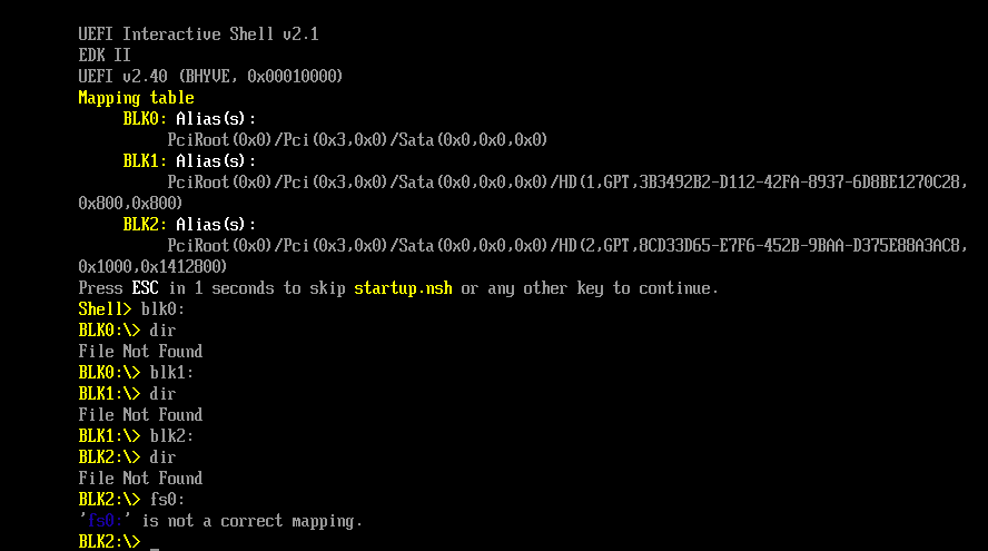

Anything interesting when you enter these into your EFI shell?
fs0:
dir

There is no EFI partition on that disk image so you cannot boot it. Install Ubuntu with EFI boot ...
Or try what I outlined above - add a second disk with rEFInd on it.

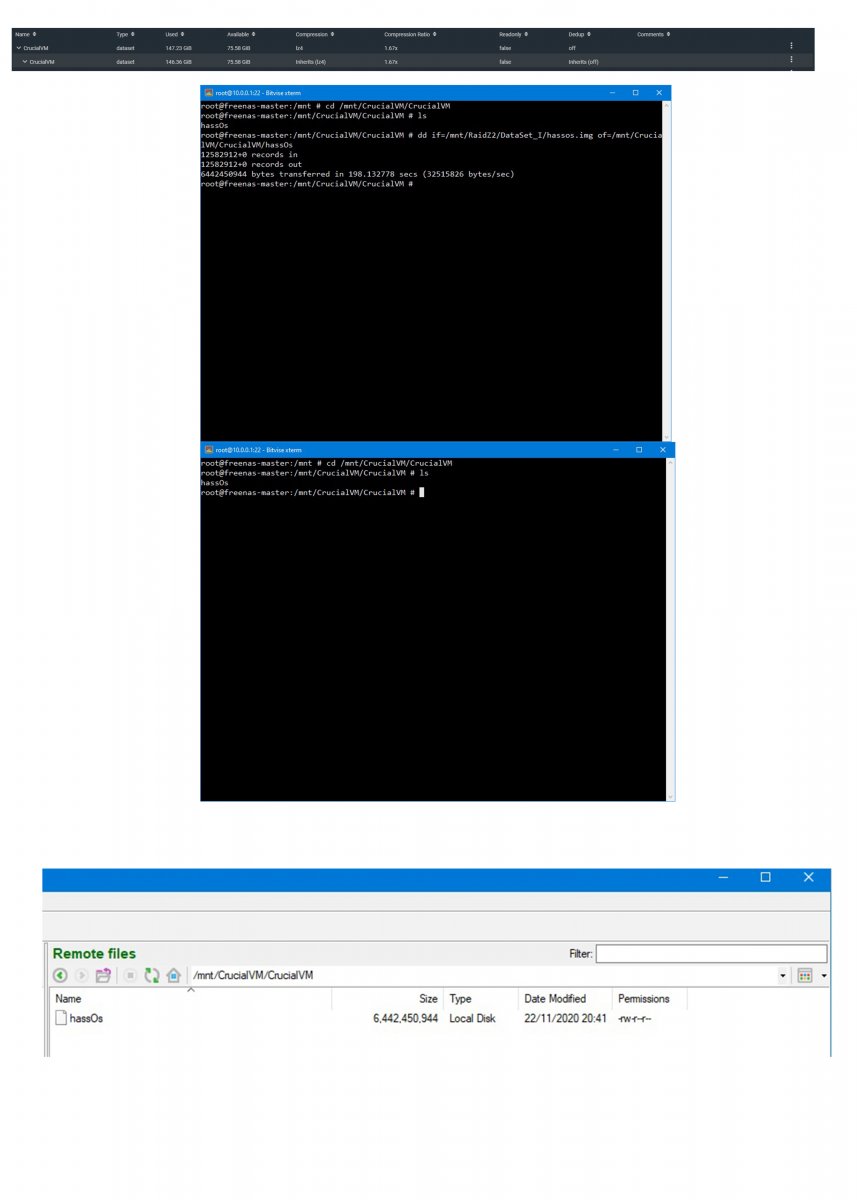

thats the command:
‘dd if=/mnt/RaidZ2/DataSet_I/hassos.img of=/mnt/CrucialVM/CrucialVM/hassOs’
all pics in same frame below
a pic from the gui, as to where i keep my zvols of vms
SSH image after the command finishes:
and the file that was created on that dataset - just a little less than 6.5 GB
as i said - it create this file regardless if there is a zvol with this name or not
how abnormal is this??? should i call mulder and scully, or ghostbusters??

The destination is plain wrong. See:
root@freenas[~]# zfs create -V 1G hdd/testvol
root@freenas[~]# dd if=/dev/zero of=/dev/zvol/hdd/testvol bs=1m
dd: /dev/zvol/hdd/testvol: end of device
1025+0 records in
1024+0 records out
1073741824 bytes transferred in 0.765429 secs (1402796906 bytes/sec)
root@freenas[~]# zfs destroy hdd/testvol
A zvol is a block device, not a file.

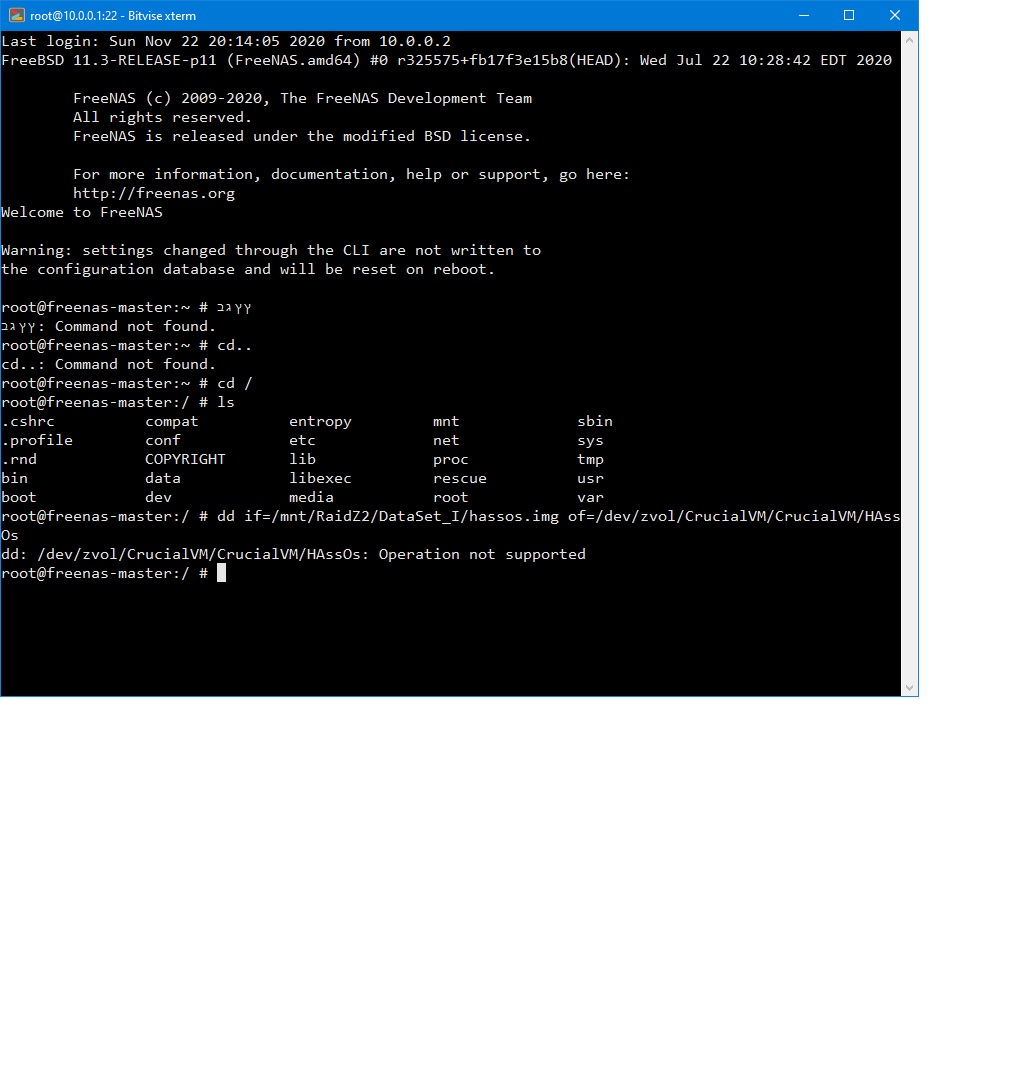

now, after pointing in the right direction - /dev/zvol/CrucialVM/CrucialVM/HAssOs (where i have already created the zvol)
i get an error of:
dd: /dev/zvol/CrucialVM/CrucialVM/HAssOs: Operation not supported
after running this command:
dd if=/mnt/RaidZ2/DataSet_I/hassos.img of=/dev/zvol/CrucialVM/CrucialVM/HAssOs
more thoughts?

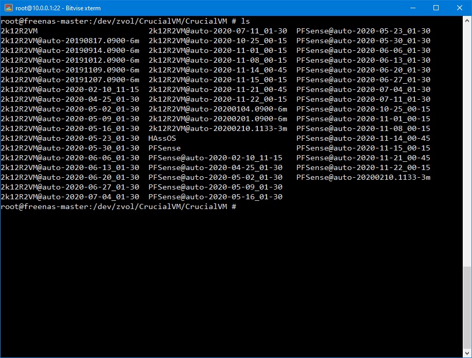

Does /dev/zvol/CrucialVM/CrucialVM/HAssOs exist? Check with ls. Apart from that no idea - works here ;)
Edit: one more idea, please post the output of
zfs get volmode CrucialVM/CrucialVM/HAssOs

it appears on 'LS' command, so my guess would be - yes
ill keep digging
