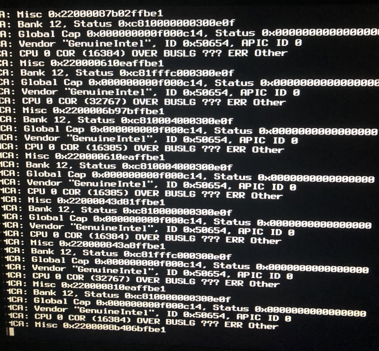

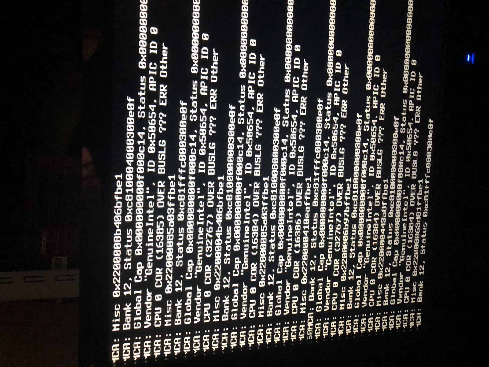

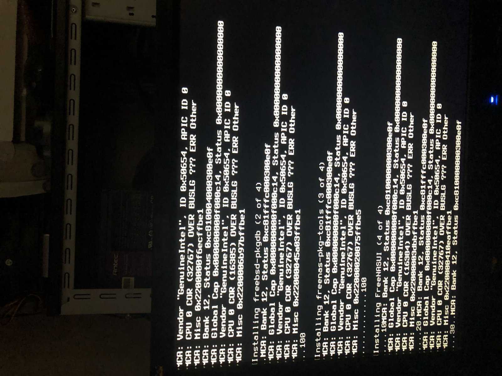

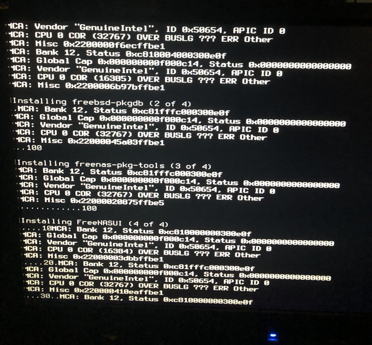

I am having a problem setting up FreeNas on my system. I can get it installed, because I can follow the guide and I know what buttons to press, but when I go t the first boot this scrolling continues and makes it impossible to complete it. I'm not sure why this is happening and I have searched through the frums and I cannot find a similar issue. I will post a few pictures of what is happening. My system specs are as follows

Quick Update. I reran Memtest and I did have a bad stick of ram, which was not the case originally. However once I removed that bad stick it ran four passes over 26 hours on the remaining 96 gb with no errors and I still get the same continuous scrolling when trying
