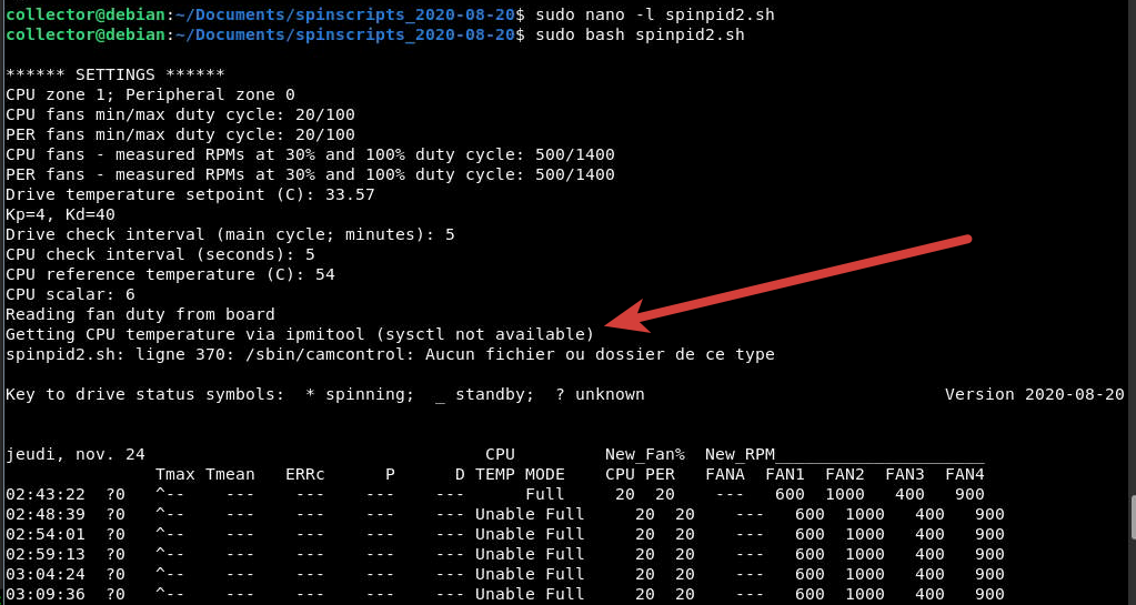

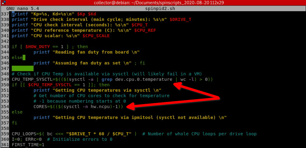

Thanks for this information, I used the scripts on Debian, the automatic fan control via ipmitool works, but the processor temperature detection does not work with sysctl, as I think the scripts were intended for FreeBSD
Here is the error message I get after running spinpid2.sh :

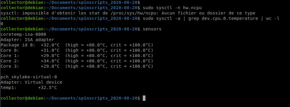

These commands do not find the processor temperature because the path does not exist in Debian, however sensors does find the temperature:
sysctl -n hw.ncpu
sysctl -a | grep dev.cpu.0.temperature | wc -l
I specify that I can't use ipmitool to find the processor temperature, because IPMI doesn't find the processor temperature anymore, and therefore doesn't manage the fan speed, that's why I wanted to use this very elaborate script, but it doesn't work for me at the moment.
Is it possible to configure another command to make the script work under Debian? If yes, which one?

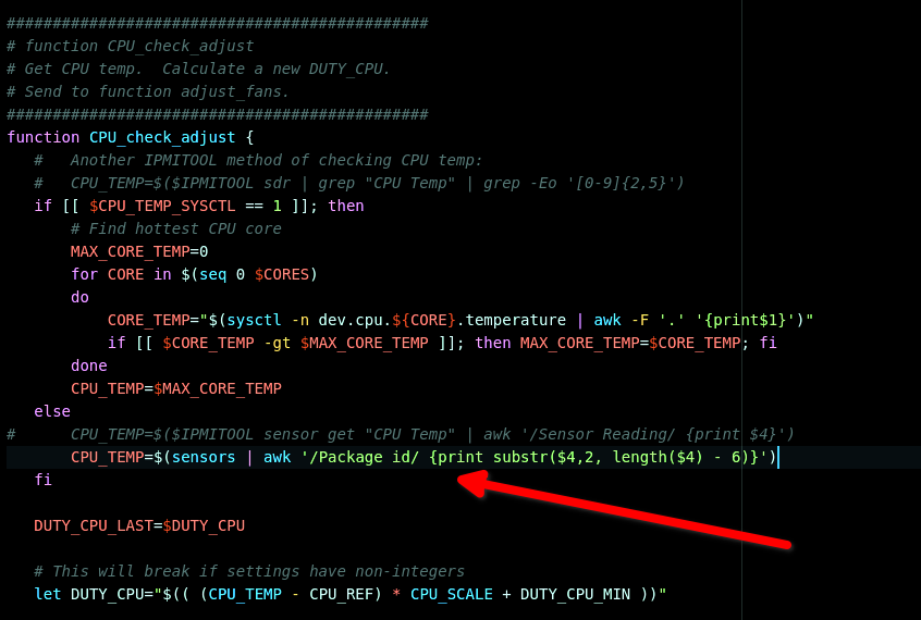

I replaced the following line in the spinpid.sh and spinpid2.sh scripts that captures the temperature by querying IPMI:
CPU_TEMP=$($IPMITOOL sensor get "CPU Temp" | awk '/Sensor Reading/ {print $4}')
By the following line that captures the CPU temperature by the lm-sensors tool:
CPU_TEMP=$(sensors | awk '/Package id/ {print substr($4,2, length($4) - 6)}')
Then I modified all the FreeBSD patches of the scripts, to direct them to the Debian repositories. But first you have to install the smartctl and sysctl dependencies which are on Debian in the gsmartcontrol and statgrab packages, here are the dependencies to install :
sudo apt install gsmartcontrol statgrab lm-sensors
After these modifications, the scripts work with respect to the CPU temperature and the fans are well managed.
