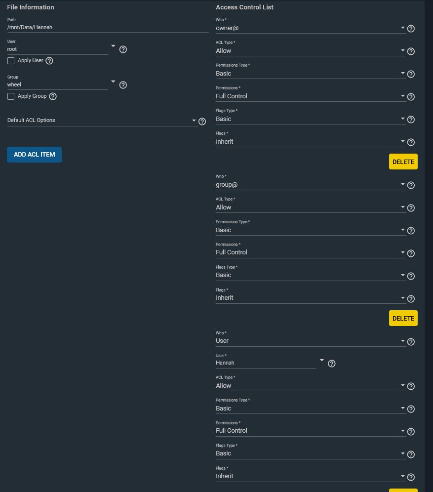

Four family members each have a dataset (using their names). I've then created the SMB shares as their names too to match the Shared folder names and for the ACL's I've done as per the attached so you'll see their are explicit permissions with the users and groups with the parents being in the same groups as the children.
The problem occurs when trying to map to each drive as using the 'Connect using different credentials keeps remembering the first login, even when I choose the correct username and using the format \\xxx.xxx.xxx.xxx\username and then the password. a couple of seconds after entering the password, the login box just reappears.
I have had a browse through the threads here and have seen similarities, but is there something solid I can do to resolve this? The main issue is one parent has access to all folders, the other parent has access to hers and the children and the children only have access to their own.

I hate to be the bearer of bad news, but what you described is an inherent and long-standing known issue with Windows. There have been complaints on Reddit and Microsoft forums, with the only official explanation that this is (somehow) a "security" feature.
It's nonsense, and other users correctly called this out: It's not a security feature, it's just laziness on Microsoft's side.
The real irony is that SMB is a Microsoft technology, yet I have the best experience using it with a FreeBSD server (TrueNAS) and Linux clients (Linux Mint and Manjaro KDE, using Smb4K to manage all my network shares / credentials.)
You did everything correctly. Unfortunately, in my opinion, Windows for the longest time (and even still today) provides an incomplete implementation of managing shares and mapped network drives. At one point I tried to find something comparable to Smb4K, but for Windows instead of Linux; with no luck. :frown:
If someone knows of such an alternative, please share!
One way to "bypass" this inherent limitation is to use the server's IP address for one share (e.g, \\192.168.2.101\linda), and the domain name for the other share (e.g, \\homenas.local\freddy). This is still not considered a "true solution" since it is limited to two different shares (will not work for three or more), and it does not address the core issue.

Thanks for the response there. I feel better knowing I was not doing something wrong. I had not tried the two different authentication methods in the same session so I'll give it a go and see.
I won't have access to the NAS for a few day now, but if that 'workaround' works, would it also work for Groups? By this I mean If one user authenticates to map to their own shared folder (e.g, \\192.168.2.101\linda) and they are also in a group that has permissions to other shared folders, once the drive mapping is complete, they would then be able to browse and access the folders that have group permissions assigned to them that that user is a member of and possibly map to to those drives too? Then, if they need to map to another share using different credentials because they have no permissions of their own or not in a group with permissions to that share and use the 'other' authentication method using local domain name (e.g, \\homenas.local\freddy), it will work and they will also be able to browse to shares that that user is a group member of?
Hope that makes sense?!?!
I think it is possible, how you described. The reason being when "linda" authenticates to the "server" 192.168.2.101, the user "linda" will be able to access other shares (via 192.168.2.101) as long as she has permission because of the group she is in. You can even use ACLs to more fine-tune permissions for different users and groups for each share / dataset.
Then "freddy" comes along, and does the same thing, but this time the "server" is homenas.local. The same applies to "freddy" as it did to linda in the previous example. The other users would have access based on their group.
