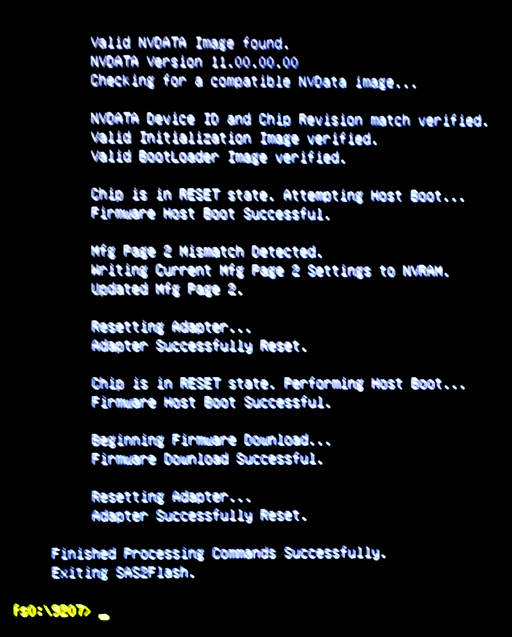

Dec 28, 2013
287
Note SAS controller ID from MB sticker
Download/Unpack 9207_8i_Package_P18_IT_Firmware_BIOS_for_MSDOS_Windows.zip
Boot into FreeDos
	sas2flsh -o -e 7
	sas2flsh -f 9207-8.bin
	sas2flsh -o -sasadd id_from_mb_sticker
Tried it and it seems like you can crossflash the X10SL7-F controller to the 9207 firmware just fine.
Although I did it from the EFI shell instead of DOS.
The controller is working well so far, although I have not really tested it too much yet.
