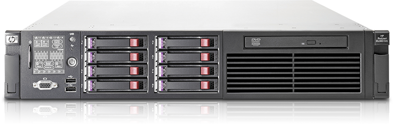

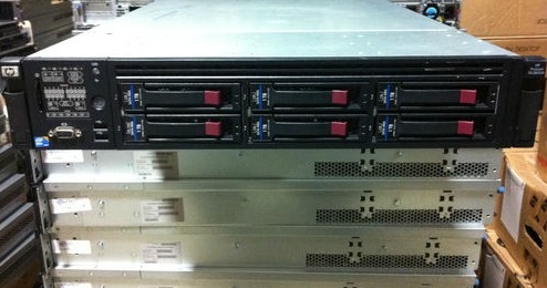

pretty sure on my DL380 G6 the backplane has 2 SFF 8087 connectors (1 per 4 hdds, totaling 8 hdds) , but my DL 380 G6 uses the SFF. Do you have a picture of your server, the SFF looks like the first image, and the LFF is the second.

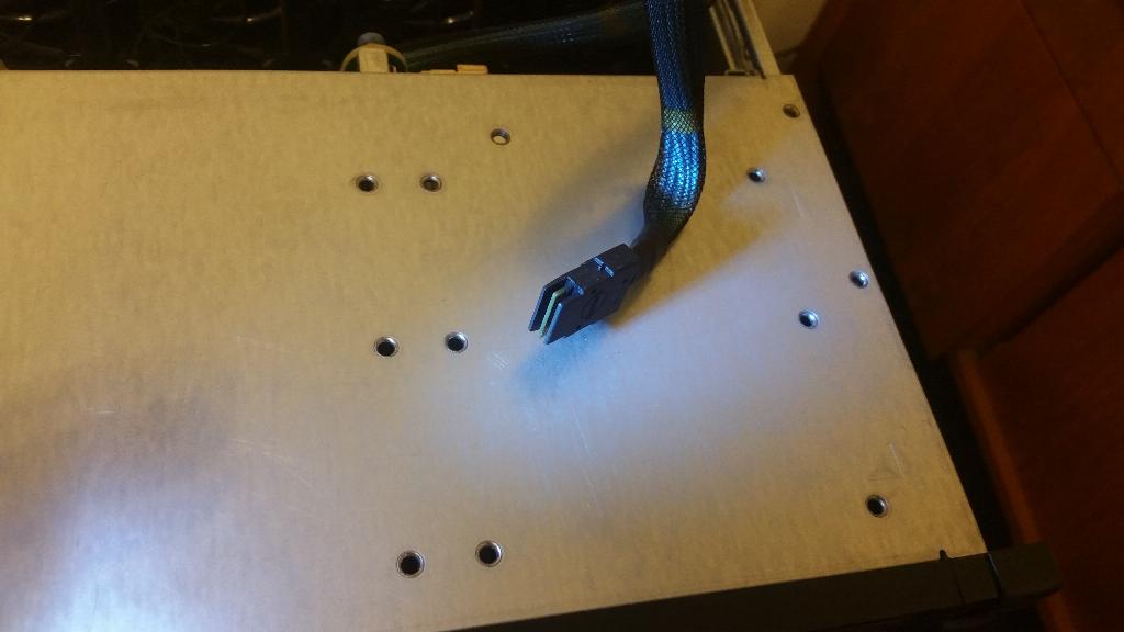

My apologies, I didn't mean to bail on you earlier, I work a 12 hr graveyard and was up 4 hours after being home already and just died about that time. Being that tired didn't help me see the connector any better either. You're right, it is an sff 8087, so it's not an issue with the connectors. So I just have to locate that type matching the other end that whatever lsi I can find has.
