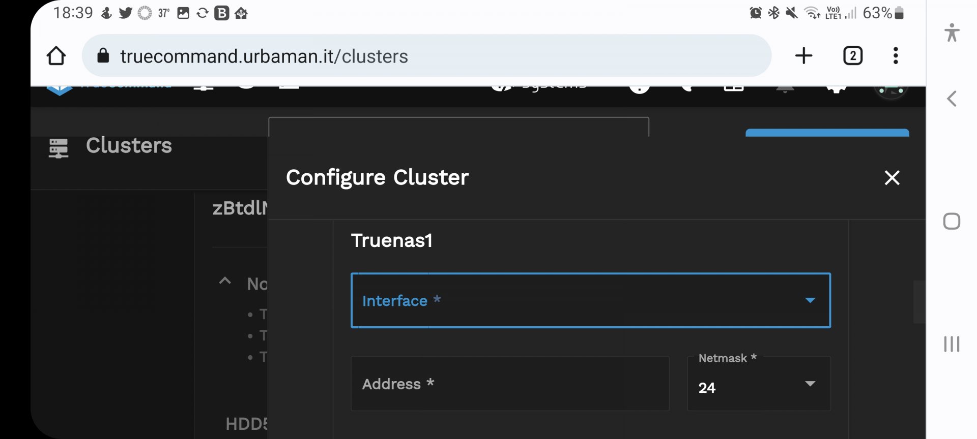

While trying to complete the setup of the cluster, the SMB share wizard comes up, but I'm not able to select network/address from the SCALE noeds.

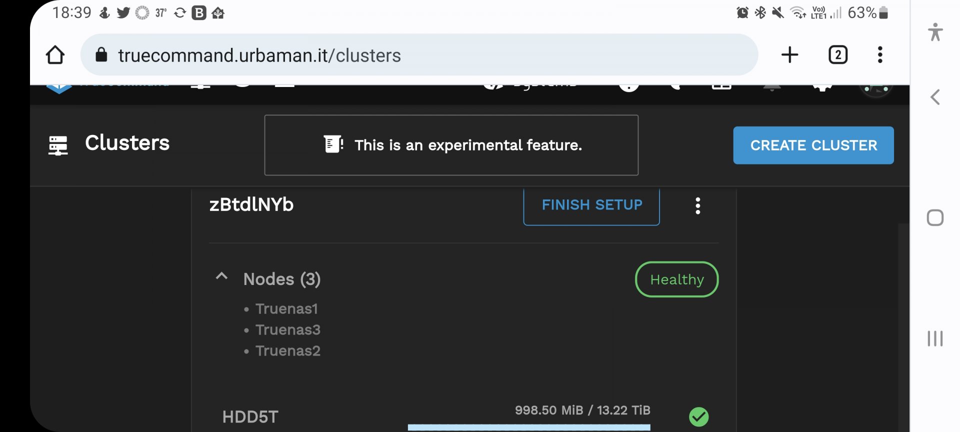

Sounds like you manually created the cluster originally? How was it setup? Guessing the CTDB / VIPS were not setup properly. Do you have a "Finish" Button up at the top of the cluster widget that can be clicked?

I created it with Truecommand 2.1, before SMB was actually enabled.
Now the "Finish" button appears, and if I click it it goeas on asking for interface/address of the three nodes, but doens't let me select anything, so I'm stuck there.

Well, but the form does not let me select any interface form the undeliyng nodes...
Is there something I should enable or set anywhere else to see them?

Can you provide a screenshot? Not sure if there's a bug or what exactly you are seeing..

Sorry if it's from mobile, but the dropdown is empty for all three nodes (they are up to date SCALE instances)

Ok, so if I'm following, the Interface dropdown has no interfaces listed in it at all? Thats annoying. Can you please open a bug ticket here with the screenshots and a debug file from one of the TrueNAS systems?
I'll get an engineer to take a look into this and we'll figure out why those aren't populating in this case.

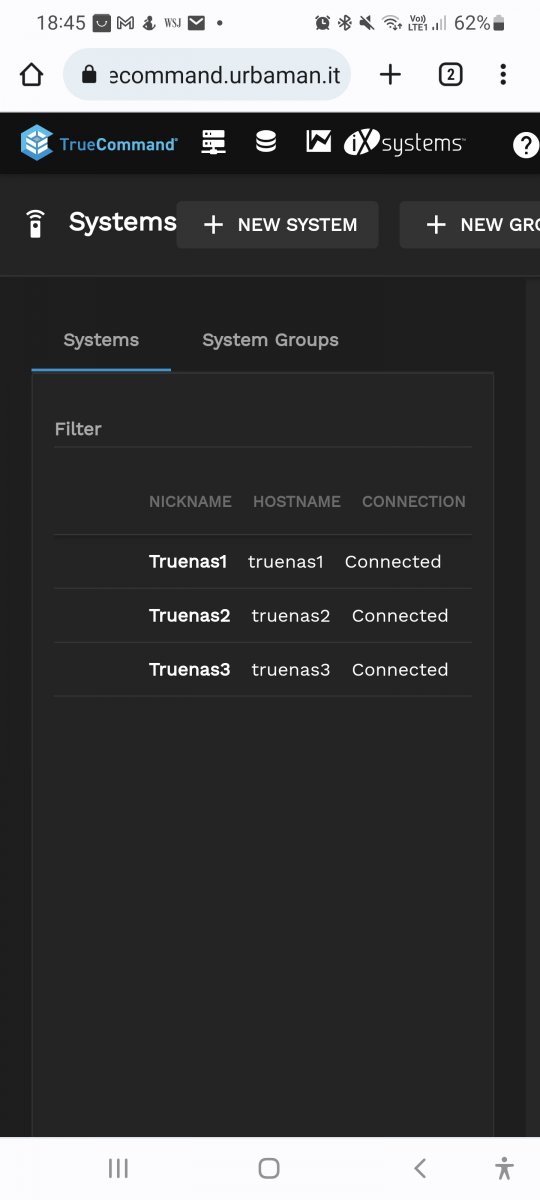

I just figured out exact same issues that you have. if you were able to add the clusters. at this step (finish setup step), if you do not see the interface. you just need to click the Menu -- system-- delete all the systems you have. You can refresh the web interface of each system, and then add them back to the true Command. after that, go back to the "finish setup". and you'll see the interface.
