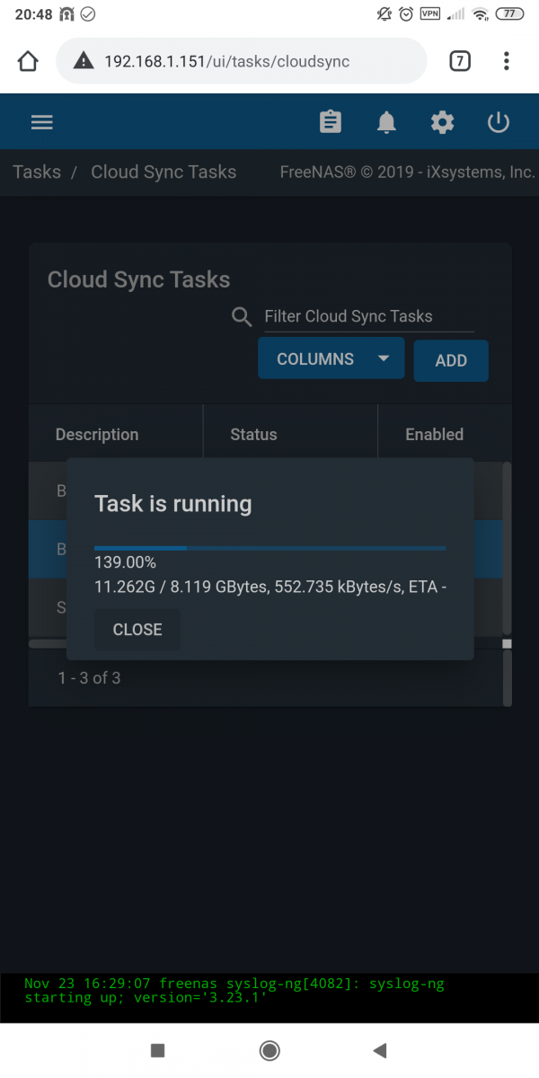

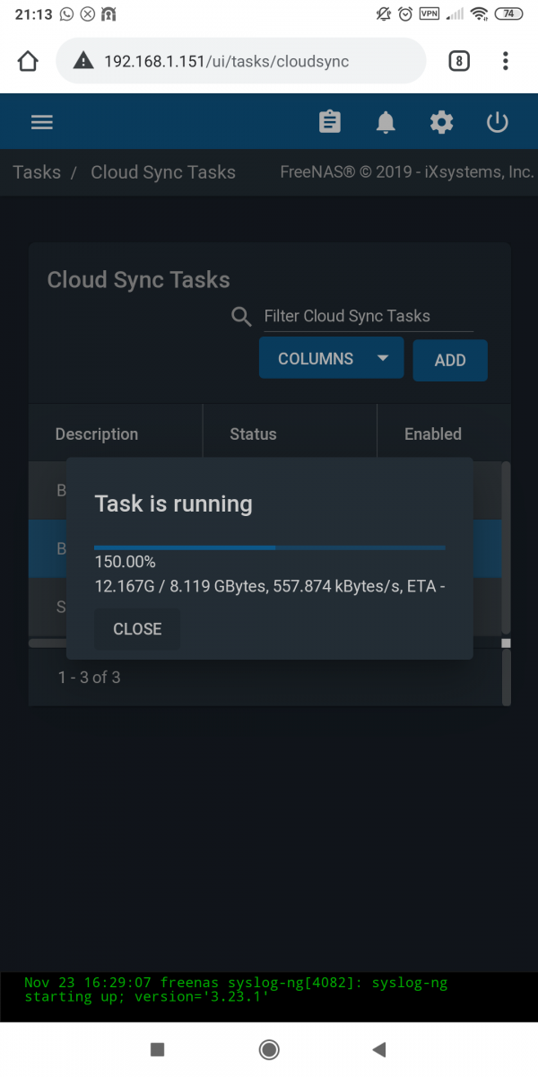

Hey everyone,
i am using FreeNAS FreeNAS-11.3-MASTER-201911151211. One dataset 295GB is also synced with BackBlaze daily. For a few weeks it worked perfectly, but now since Upgrading to 11.3 the cloudsync for this dataset never finishes (for to other datasets it works perfectly fine). In that time no change of data on this dataset took place (which obviously then needed to be synced).
FreeNAS is pushing since almost two weeks nonstop data to BackBlaze. Every day it is pushing more than 100GB to BackBlaze (even if no data have changed) and is never finishing this process.
Where can i find a log, what's going on there? I just attach some screenshots of the situation at the moment.
Like i said, for two datasets, it works perfectly fine. Just this one dataset is never finishing.
Brgds

So, this problem solved by itself.
My internet connection had packet loss and cosequently the cloud backup never really finished. After switching to a backup-connection, it worked now smoothly again.
Next step, check the cables for my general internet connection (found out this fault, after i check the logs in the modem&router).
