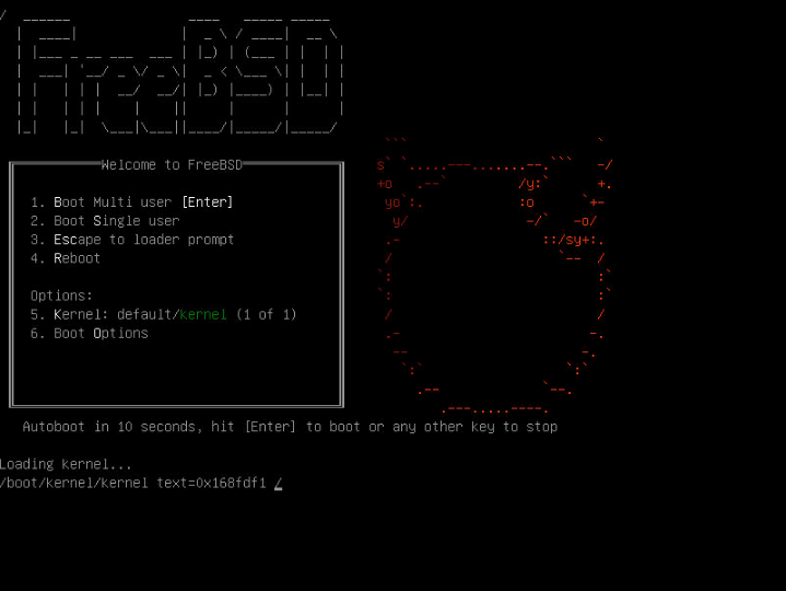

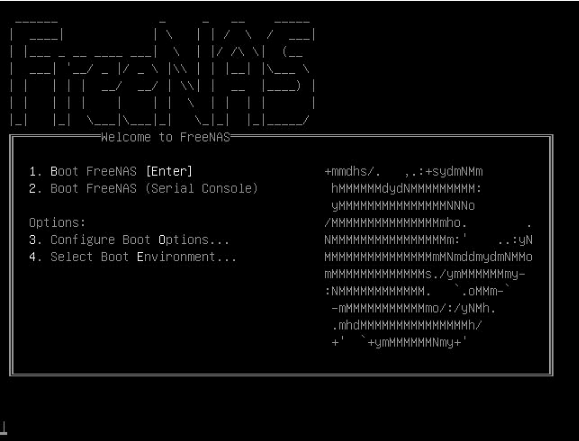

I have tried disabling C states, using Legacy and UEFI bios options.
This board does not have a BIOS with CSM option.

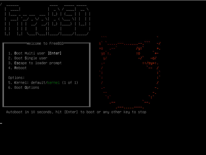

Upon pressing 1 or Enter on the boot loader screen of either an installed FreeNAS installation, or the install media, will continue without issue.
I can confirm this is the exact same result regardless of configuring for BIOS or UEFI.
Once booted into FreeNAS, everything works perfectly. All drives are showing up and able to be configured.
Is there a boot parameter that I can use in order to work around this?

Further testing of Free BSD indicates that the current Production Release of 12.1 experiences the same issue.
I tested using the "FreeBSD-12.1-RELEASE-amd64-bootonly.iso" image.
I'm hoping that someone might know a system tunable or boot loader parameter to get around this issue.
As per usual, simply pressing Enter moves past this hang, and allows the system to boot.
