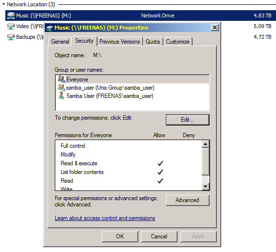

After following the steps above (your screen shots) my phantom user is gone, replaced by the new "Samba" user I created.
Seen here:
I am still unable to grant "Full" rights to the "Everyone" user though. :(
anodos wrote,
I noticed that you have mapped a directory within one of your shares and are attempting to modify its permissions. ... Don't map "\\FREENAS\MUSIC" and change permissions on "Frank Zappa".
Ah! I did *not* try to chg permissions on the folder within the share. I just happened to right-click on whatever folder was open at the time in order to get to the "permissions" display dialog. That screen accurately represents the whole share. I never would chg permissions on any sub- folder.
I noticed your datasets owned by "nobody" (your guest user), but you are authenticating as "richie" this will effectively make your permissions level that of "everyone" which tends to be RO.
Not having been aware "Everyone" is normally a RO group I now wish I'd recorded permissions BEFORE the issue starts! No idea how to was working before the big bang...
So literally wanting EVERYONE to access CIFS shaers ... What to do???

No snapshots, screenshots, or logs from BEFORE the permissions change. BUT no worrys!
==> Unless I find a way to fix this so I can delete files from the shares, I'll AGAIN have to rebuild the server from the ground up for like the 6th time!
I don't need EVERYONE to have access, that's just the way FreeNAS creates the share. I never manually set any particular user or group.
So you're saying that if I go to FreeNAS and make myself (user: Richie) a member of the "samba_user" group I should be able to read / write?
HEY! What do you know! Fixed!
Live and learn.
Love y'all,
Rich
