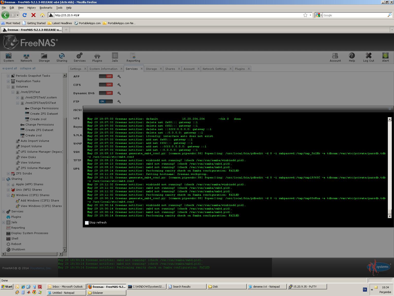

"Performing sanity check on Samba configuration" messsage has been received during CIFS initialization. Screenshot and SMB4.conf files have been attached.
Following thread has been checked, but not solved. Could you help us pls?
https://bugs.freenas.org/issues/4194

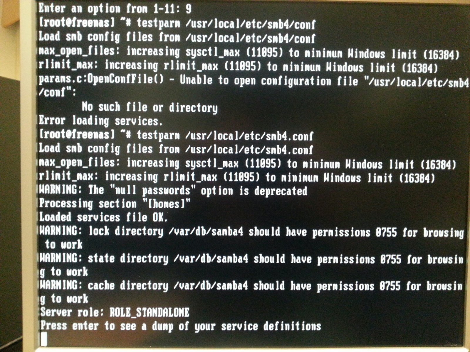

Please post your entire smb4.conf file. I don't think you copied the entire file. An easy way of getting at is it is to enable ssh and use sftp (via program like filezilla) to copy it off the server.
Please also post output of 'testparm' command and the version of FreeNAS you are running.

Hello Anodos,
SMB4.conf and testparm output have been uploaded.
