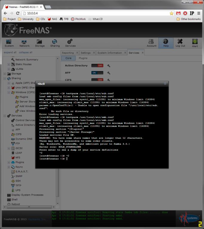

- Executed "testparm /usr/local/etc/smb.conf"
If anyone can help me out any further as it seems I can no longer enable the CIFS service in the webGUI.
