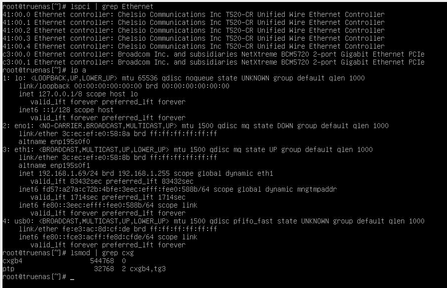

Hi, this my first real stab at TrueNAS (version 22.12.3.3) and it's been mostly smooth. One issue I have run into is that my Chelsio T520-CR 10gbe NIC is detected but doesn't show up as network interface. After doing some research it seems like cxgb(4) supports the older chips and cxgbe support the T5, but it seems like its not installed with the default installation of TrueNAS. Am I missing a step? I had gotten the impression that the T520-CR would work right out the box. Thanks in advance for your help and support.

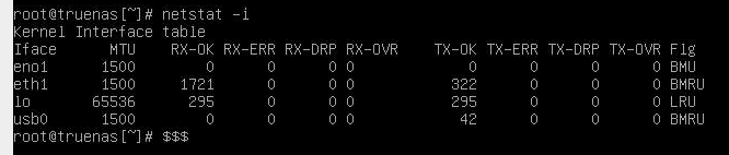

Do you have netstat -i available? On my TrueNAS Core 12.X system, a T5 type interface is listed as a cxlX.
Evan000
Sep 9, 2023
Still doesn't show the interface. Just the two 1gbe on the motherboard and the supermicro usb0 interface. Seems like the hardware is fine as the Supermicro bios can see the card and configure it.

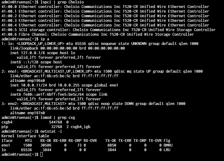

I am having a very similar issue
The system sees the card, but wont list it as a interface:
I believe I need to installed the driver for cxgbe but am not sure how to go about doing that.
The Supermicro H11ssl-i BIOS can see the card. I can even enter the Chelsio Setup Utility, so I do not think it is a hardware issue.
What step are we missing?

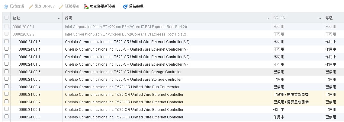

Today, I added one Chelsio T520-CR to my server for SRIOV VF, it didn’t work.
After upgrade firmware, it works.
Be careful, the new boot rom file, cubt4.bin , show error, the file size is too big.
Needs to Choose T520-CR, boot, ipxe, download, upgrade.
TrueNAS Scale , ok
TrueNAS Core, fail.
Under ESXi
Do not pass what NIC you see.
Must pass VF NIC
VM
windows 11 , ok
Arista NG Firewall , ok
TrueNAS Scale, ok
Finally ‍

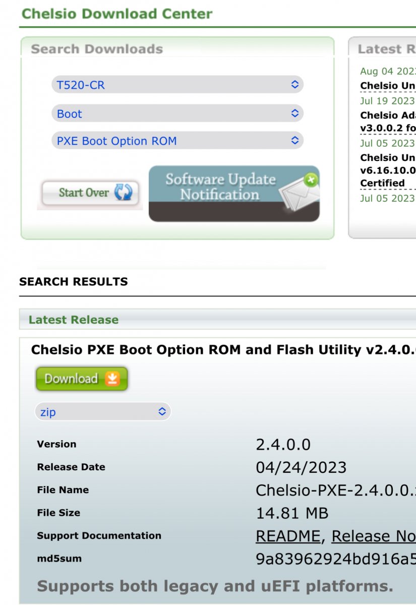

Before update option rom, I also can not use T520-CR with TrueNAS scale.
Option rom has new version ,20230424.
