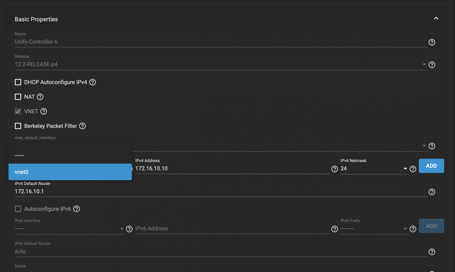

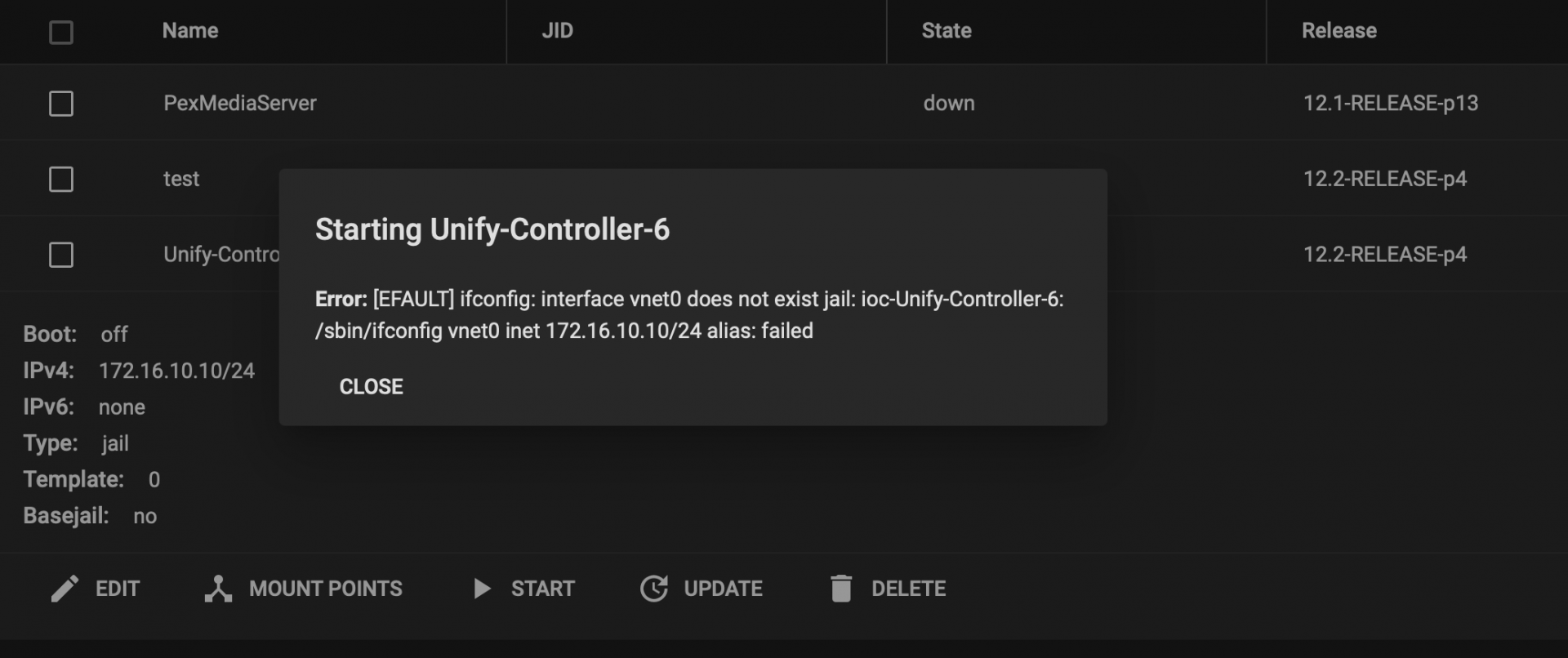

you say vnet1 ...not vnet0 as defined, and oh btw, i did not pick the name. was created when i created the test jail.
georgelza
Feb 24, 2021
417

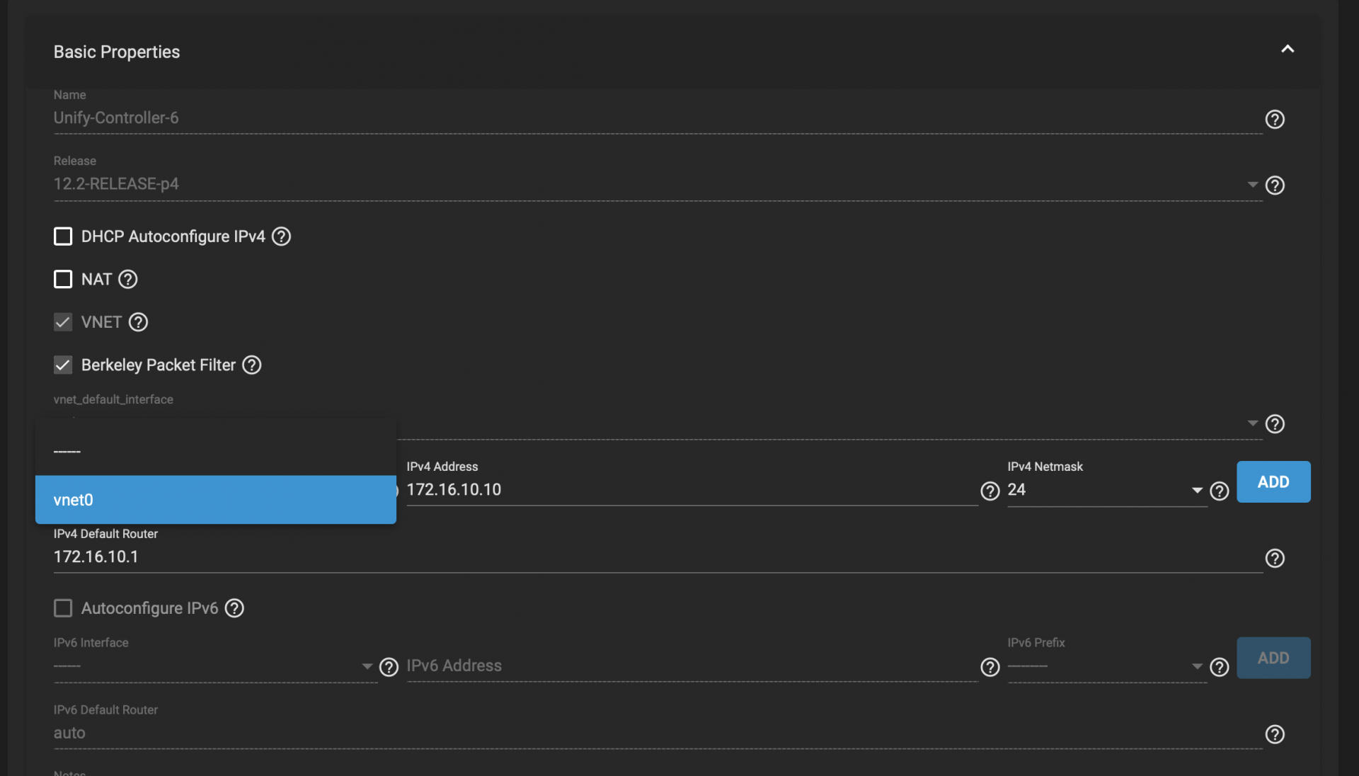

9,700
No.
From your extract of the jail properties:
vnet:0
vnet0_mac:06aedba63966 06aedba63967
vnet0_mtu:auto
How I think it should be (would match with one of my jails which uses vnet0):
vnet:1
vnet0_mtu:auto
vnet:1 as far as I can see refers to vnet being enabled vs not enabled if it's 0.
