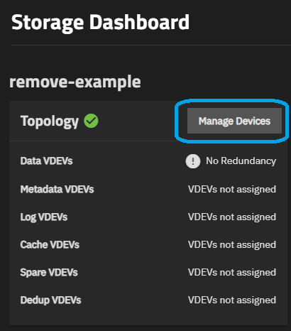

Under the Storage dashboard, choose Manage Devices beside the Topology section of your pool:

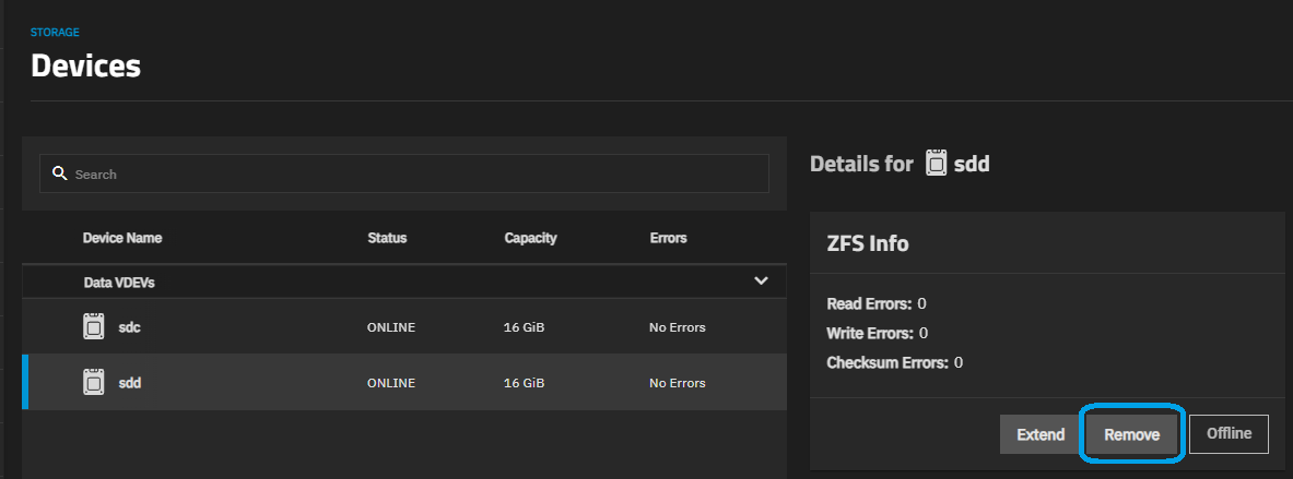

In the next window, select the drive you want to remove, and then click the Remove button:

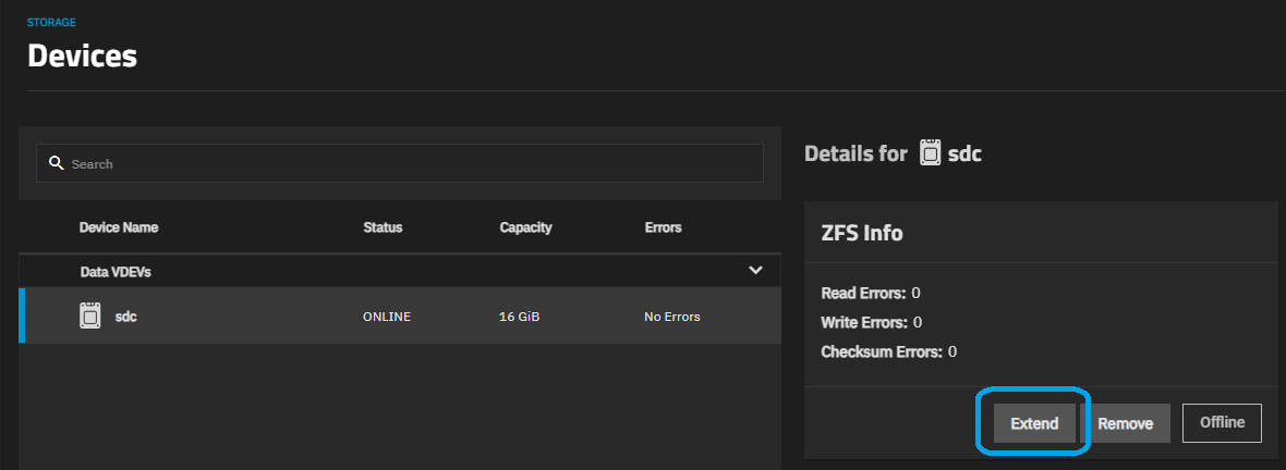

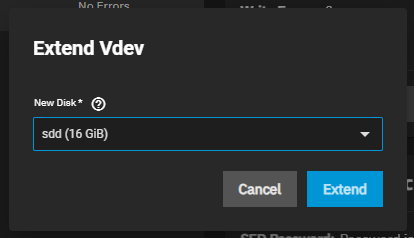

Confirm the removal and let it complete, then select your 1TB disk and this time click Extend:

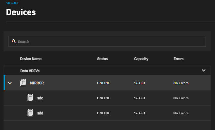

Select your 2TB disk, confirm, and you're all set. Let it complete the resilvering, and you now have 1TB of usable space on your 1TB+2TB mirror.
Later on, you can use this same Topology screen to Replace the 1TB disk with another 2TB, and you'll have a 2TB-usable mirror.
