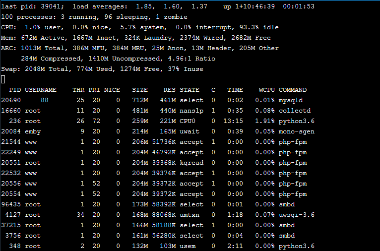

I did some experiments last night on the 8GB machine (the only one I have physical access at the moment).
I tried monitoring memory usage while starting the incriminated jails. When I start those the graphs in the dashboard and in the reporting page go to zero and they recover when I the jails are shut down.
So I used top to monitor. As you can see mono (i.e. Emby), php-fpm and mysql (i.e. Nextcloud) are using some memory but there is still a lot of free memory. Of course I now ZFS, when possible, will use it all as ARC, but still...
EDIT: Expanding to 16GB is on my todo list, but since this issue happens also on the 16GB machine I'm not sure this is "the" problem. Also, I don't want to complain that much about RAM usage. I knew this when I decided to go with FreeNAS, but just adding RAM without understanding exactly why I should need it is not really ideal.
The system slowed down a lot when I started the jails but was still usable (apart from the graphs at 0). I left those jails running yesterday night and this morning the system was completely hang. Was not reachable over the network and I wasn't able to access the console physically (after typing any number, I got no response).
I proceeded to hard reset it and after it came back I dumped the logs.
