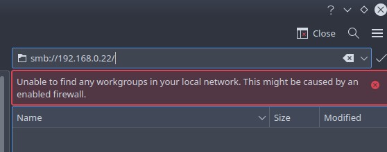

Any particular reason why you are not using dolphin to access your smb share(s)?

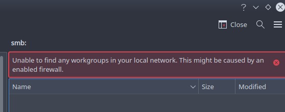

As for "using Dolphin" I assume you mean navigating through Dolphin to "Network" and then "Shared Folder (SMB)", correct? When I do that, it says "Unable to find any workgroups in your local network. This might be caused by an enabled firewall." I have no firewall enabled, so I'm not sure what the issues is. Under the SMB service, the netbios name is set to truenas and the workgroup is set to WORKGROUP.
If that is not what you meant by "using Dolphin", then I'm not sure.

That probably means it relies on the netbios name server. That said, I believe dolphin uses libsmbclient rather than the kernel SMB client. I prefer the latter.

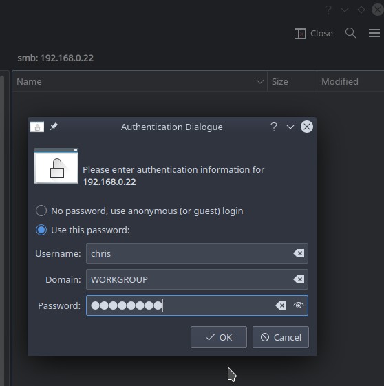

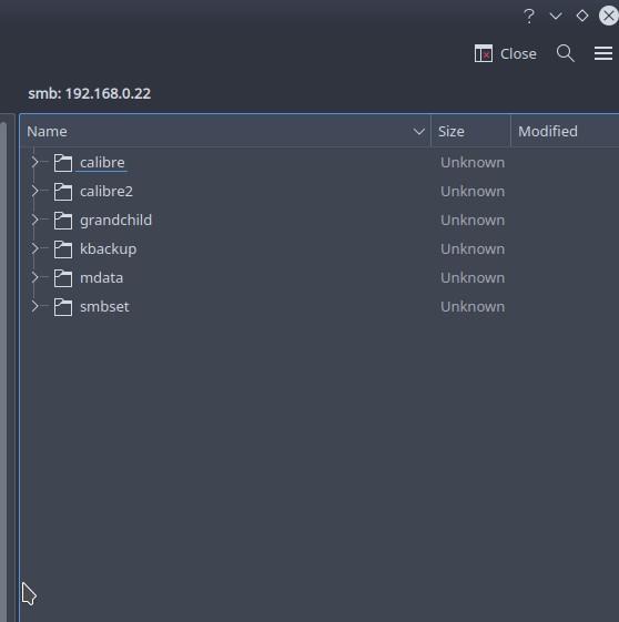

@Decoy256 You can ignore that error message and just type in the ip of your NAS, followed by the user creds when prompted. See below. It's true that in recent Kubuntu versions, and other kde distros, dolphin uses it's kio plugins for connection and mounting remote filesystems. Performance can be slower than using a linux kernel CIFS mount. The latest LTS release of Kubuntu is a few weeks away and the performance of dolphin + smb connections should be improved.
