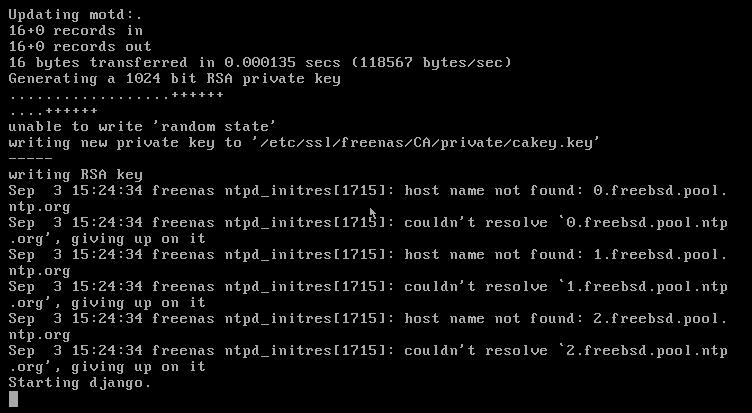

I just wasted a couple more hours on this project:
1. Yes, I am using 4GB USB drives.
2. My problem has nothing to do with checking or unchecking the "hash" box on Win32DiskImager.
I have tried redownloading, unzipping, and loading the file on my two different USB drives. No change in behavior. Out of curiousity, I then downloaded, unzipped, and loaded the 32-bit version of the file on a USB drive. Still no change in behavior. This issue is getting frustrating. I watched the firmware post and noticed boot errors. I will, presently, post screenshots, if I can figure out how to do that. :mad:

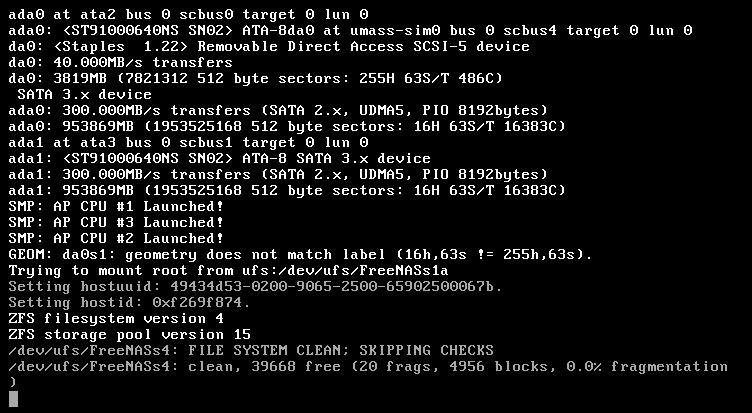

NASA
Sep 2, 2012
66
Here is the first screenshot:
jgreco
Resident Grinch
May 29, 2011
18,680
And it stops there? If so, it's hanging at some point during boot.
No, it does not stop.

cyberjock
Inactive Account
Mar 25, 2012
19,526
Your screenshots show that the disks are being detected as ada0 and ada1. They're ST91000640N's. I would zero out the entire disk if I were in your place. If you don't have a way to do it easily you can use a disk called Parted Magic. It has an eraser tool that will zero out the entire drive. It will take a few hours, but it may fix your problem.
