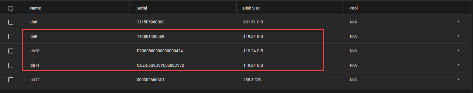

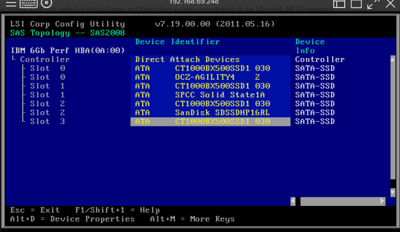

Additional info here. I decided to dig in a little. Rebooted and jumped into the SAS Config. It is indeed seeing all 7 drives. Pic below. But when I boot, Truenas only sees 4 total and the 3 smaller ones I added seem to replace 3 of my other new ones. Seems to be something FreeNas is doing but not sure why. Attached are also two outputs of /var/log/messages of bootup with and without the 3 smaller drives.

OK so after more research I saw someone talking about the firmware. Figured it can't hurt to give that a whirl. I followed this guide here Firmware Upgrade. And while its a bit dated. It did fix it! I'm not sure if this is the latest firmware or not but it got me where I need to be!
