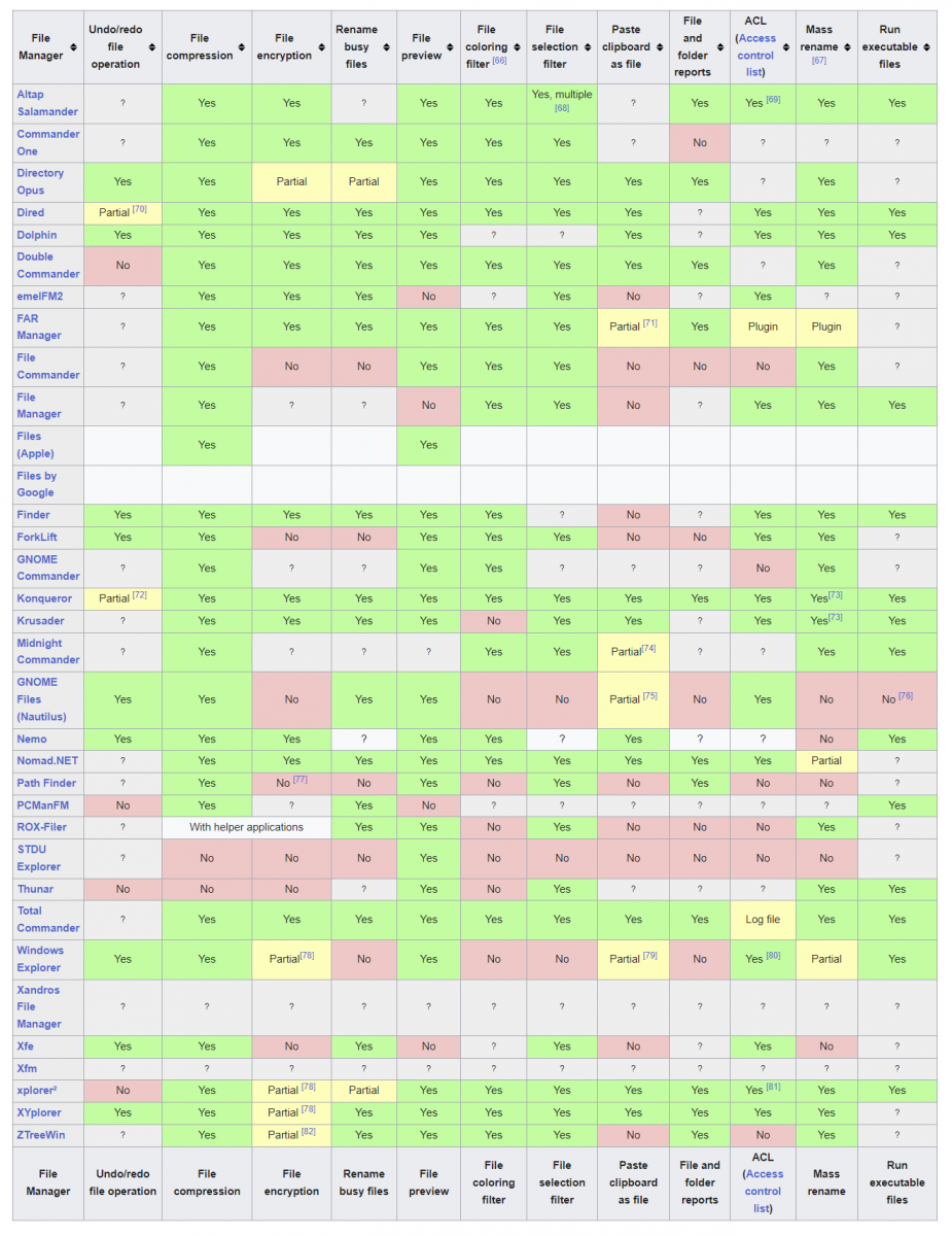

ACL wasn't problem, file manager was the problem in my experience.
It is fine after I switched from Total Commander to XYploer.
Not sure if it is the case for you tho.
ACL support list:
