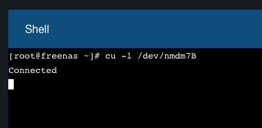

@diskdiddler i'm not seeing huge spikes in load on freenas, so I'd guess it's not the same issue happening here? It's also not showing that 'all ports busy' message - this screenshot was taken after minutes of just sitting there with the cursor blinking. Looks like it's never going to get to the VM prompt:

Why do you expect to be able to make a serial connection to your VM? Have you modified grub/kernel params to provide connection over serial connection?
I dunno, I'm not super familiar with configuring those. I kinda assumed they would just work. All things considered, that's kinda a nice to have as I wouldn't use it much unless there's a problem with ssh.

There's no serial console by default for a typical linux distro, see here for a post-install config example: https://www.hiroom2.com/2018/04/30/ubuntu-1804-serial-console-en/
