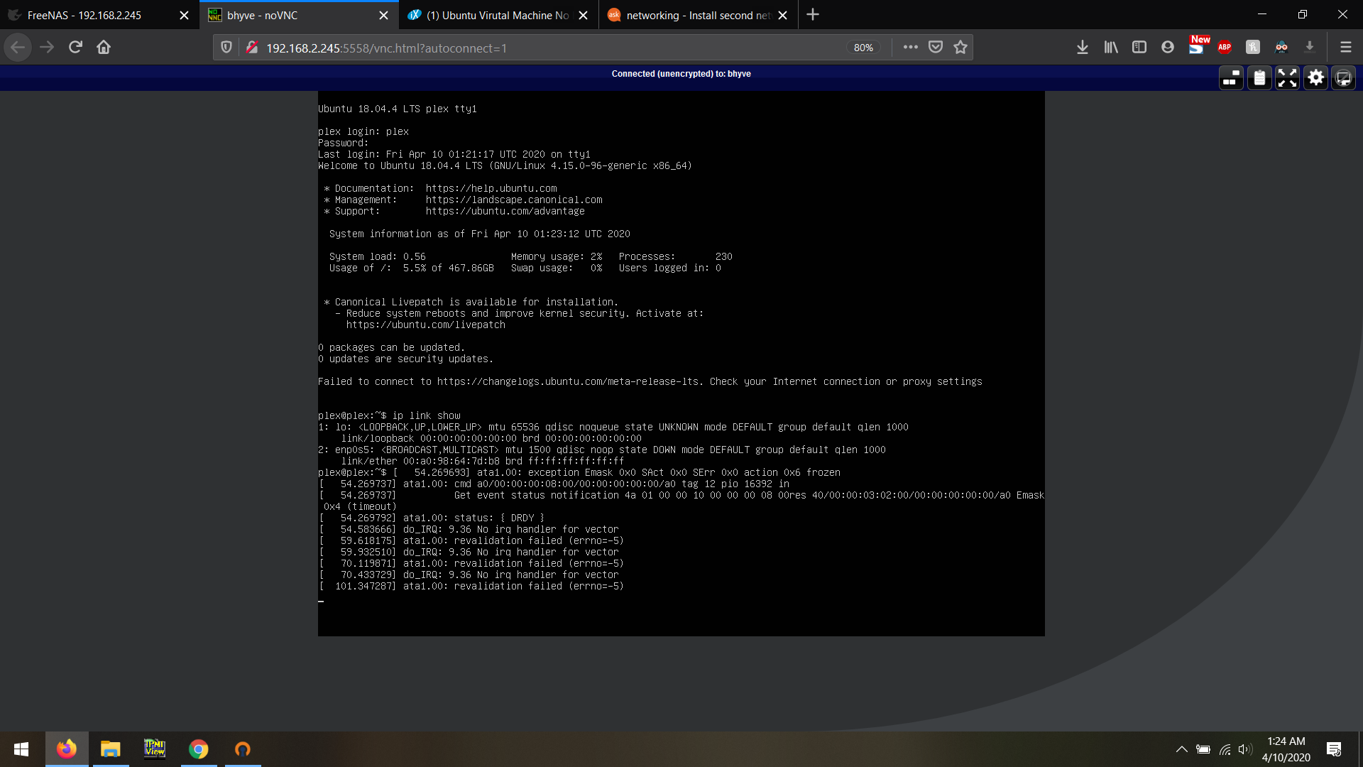

I have changed my VM to Virtio drivers as I too was using the default AHCI. The VM now fully boots and allows login to the terminal, but networking is broken so Plex can't connect to my network shares. How should I go about fixing the network? (For linux VMs I always select Virtio adapters)
I am also still seeing a few errors pop up from the previous problem.

@kaamady Check your Ubuntu VMs netplan config is referencing the correct interface "enp0s5" ....
Patrick M. Hausen
Nov 25, 2013
7,776
Check with ifconfig -a if your interface actually is that one. ;) Adjust /etc/netplan/* accordingly.
Wonderful! Thank you. Plex is back online and everyone is happy now haha.
