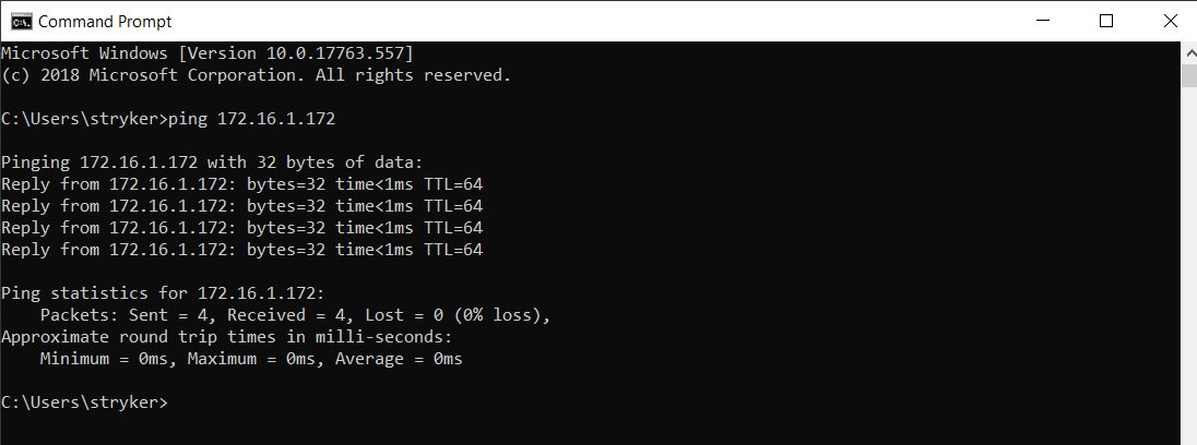

i can ping her as seen below but i cannot ssh in.

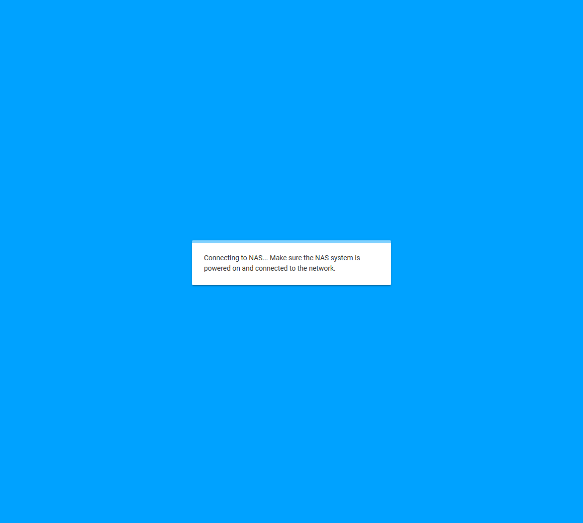

i tried jacking in directly to the box but still same results with ssh and also the web front-end
