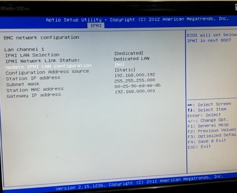

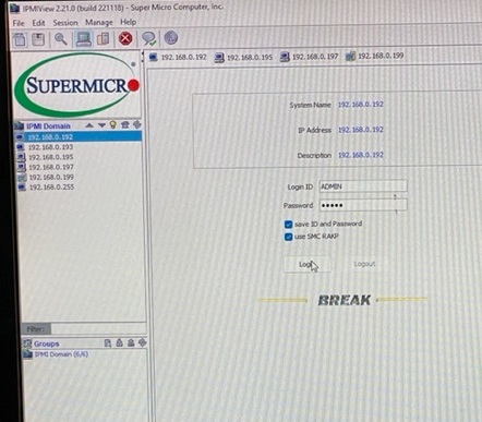

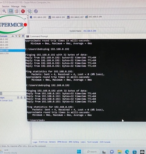

I cannot access the BMC on my supermicro X9DR-F MB using the edge or chrome browser using the IP address. So it seems it is something else. I setup a static address in the bios. I can ping that address successfully, but IPMVIEW can't access, it but can find it. I have a cable plugged into the IPMI dedicated ethernet port. I don't see an IPMI password in the bios. Any ideas on what is blocking the access?
IPMIVIEW will not access my servers (X9SCM) if the "use SMC RAKP' box is checked (as it is in your screenshot).

Thanks for the help. That did the trick. 2nd user was ADMIN. This is a second hand board and the password had been changed by the previous owner. Too old for the unique password SMC uses today. I think so, there was no label (Patrick). I also needed the tip from Redcoat. It sure is nice that IPMITOOL is supplied with Truenas.
