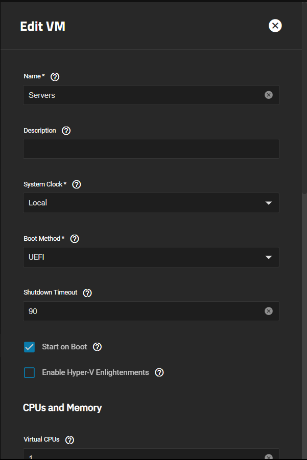

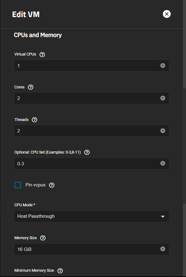

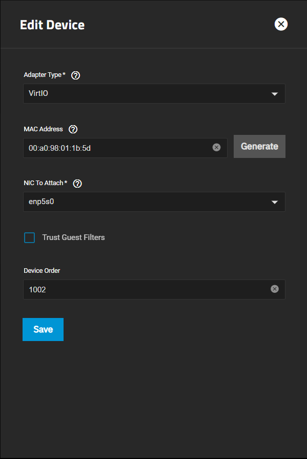

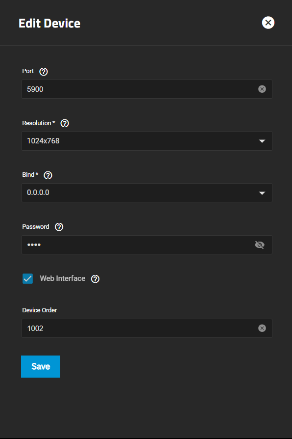

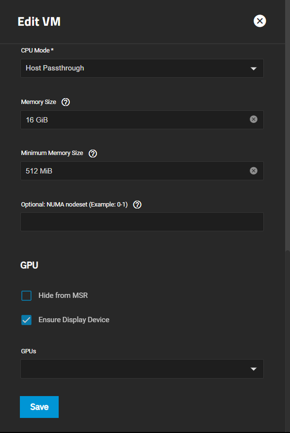

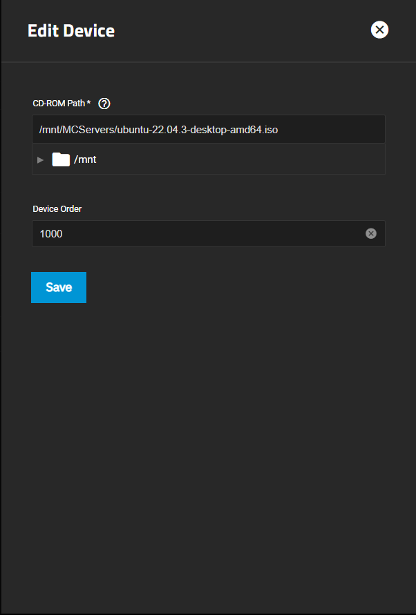

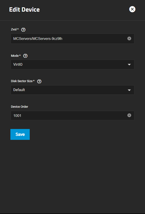

Hy there!!!
Im new on TrueNAS and recently I installed TrueNAS SCALE, in terms of a NAS system works perfectly, but recently I wanted to use a VM to run my Ubuntu game service server, I tryed to install Ubuntu Desktop, Server, Linux Mint, Debian or any Linux distro but in the live install boot it starts to run slower until it totally freezes, making impossible to do anything.
I searched on a lot of forums, watched tutorials, asked for help to professionals, nothing can fix it.
One of the most mentioned things is to use 2 cores 2 threads, i did it, nothing changes.
I also tryied to use VirtIO and emulated hardware options in the disk and the NIC, it still freezes.
The VM have 16GB of RAM assigned, so RAM is not the problem.
I also tryed to make the disk have 20 to 80GB of space, tryed even to pre create the disk, nothing works.
I tryed every thing possible and can't figure out whats the problem, here's my VM settings and NAS system specs, hope somebody can help me.
Motherboard: HP E93839
CPU: Intel Core i5-2400
RAM: DDR3 20GB 1600Mhz
Boot disk: Kingston SSD 120GB
VM Disk: Same Kingston SSD 120GB
Other Disks: 2 Seagate Barracuda 500GB 7200RPM
TrueNAS version: TrueNAS-SCALE-23.10.1.3

I'm not sure how capable a desktop environment is supposed to run on truenas with a i5 2400, I do not use anything with a graphicsl output. I tested win 10 shortly and it was a bit laggy. I could imagine the VMs may run a bit more sluggish compared to bare metal.
I never bothered with the optional CPU set:,.maybe leave that blank.

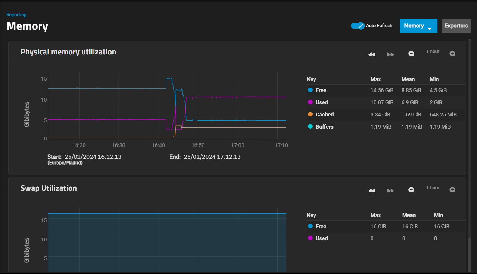

What I could imagine is you run out of RAM. Can you monitor the RAM usage in truenas please? Under reporting and then memory.

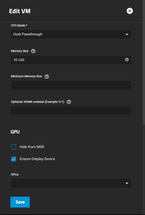

In my opinion you should not set s minimum amount of RAM. Just assign whatever RAM you want to assign and be done with it. You should not overcommit memory anyway, maybe the ballooning RAM isn't doing you any favors.
20 GB available RAM, that's 10 GB for caching, leaving you with 10 GB. From that 10 GB you would need to leave some overhead for the system itself. 16 GB assigned to your VM is way too much!
I would not assign more than 4-8 GB in your case to be honest. And 8Gb may be more than I'd be comfortable with.
I'm not sure if the buy is fixed yet, but in order to change your VM settings you would need to recreate the VM (for now).

If I don't set the "CPU set" option it only uses one core of the host machine CPU and runs even more slower so I think I will leave it on 0-3.
About the disk, yes, I refer to the same model, the TrueNAS OS its located on a separate drive.
In therms of RAM i need the VM to have as much RAM as possible because the game server requires at least 10GB.
Anyways I unset the Minimum RAM option and lowered the RAM setting it to 8GB and it worked perfectly fine!!!

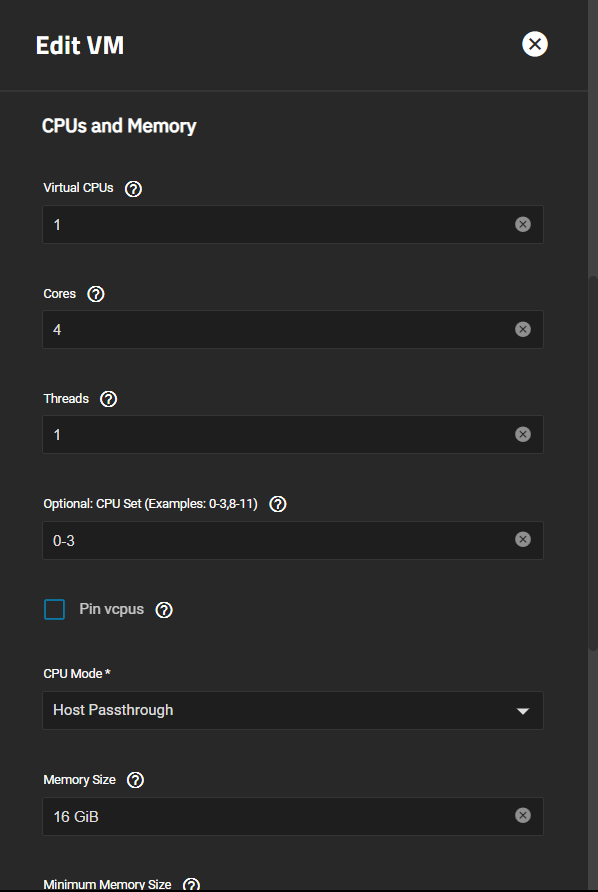

After having got it working i tryed to set 4 cores 1 thread per core (Same specs as the host machine CPU) and set 16GB RAM again, and it perfectly works!!! So I assume that the problem was "Minimum RAM" option, I feel quite dumb for not having tried to disable it before but it works fine and that's the most important thing.
I attached screenshots of memory report with the VM without any load, I think it assigns RAM dynamically and set it to 16 because after some search I find that TrueNAS SCALE only uses 1 to 2GB to run porpertly.
Anyway, I am attaching screenshots of the current configuration in case there is anything else I can do to optimize the VM.

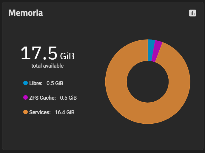

Ok, I have started the installation and I can confirm that 16GB is too much.
As soon as the installation is finished I will lower the RAM, now I don't want to cancel it, I know it can by so problematic.
I didn't google your CPU before. Yes it was a mistake to set 2 cores with 2 threads, the only correct configuration for you is 1 thread and X number of cores you want to use (up to 4).
When you have hyperthreading, then you can go for 2 threads per core.
yes the RAM is used when needed, but nonetheless you should not overcommit. Again, truenas scale uses half your memory as cache. This only leaves 10 Gb for the system and your VMs. Even if SCALE only uses 2 GB (I would leave more headroom) you cannot assign 16 Gb out of 20 Gb for your VM. This will inevitably lead to stability issues when the VM actually needs the 16 Gb.

Yep, now its running perfectly fine with 10GB and 2GB Free, so if it needs some more i will simply change it to 12
I know, but I didn't read propertly the option description and set 2 thinking its total, not per-core
