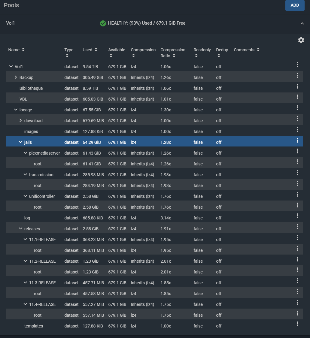

I found that deleting the jail did not delete the directory (dataset) where the data for the jail was stored. Did you take a look at the storage location?
Keven
Aug 10, 2016
114
from here it does look each time i delete a jail the dataset is gone...

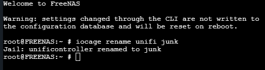

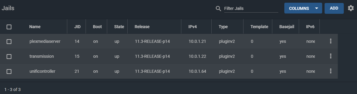

wtf
how it can show as "unificontroller in plugins and jails but, if i rename "unifi", it rename "unificontroller" to "junk"

That's the problem I was having. I'd rename it back to what it was for now. Also I wouldn't be using the shell in the web interface for anything more than running a simple command. Use something like putty instead.
iocage list will show what jails you have.

Yes it did worked, there was no "unifi" but unificontroller" and as @Jailer said jails can't start with the same name... It must be autocompleting by itself under the hood when just typing unifi. So what I did is I backup my config of unifi plugin then rename it to junk then make the jail unifi and then restoring from the backup in the jail. After making sure it was working properly I could delete the unifi plugin which the jail was named junk. I don't know if you could be running the plugin with another name than what the plugin is created for, but it wasn't my use case so I did not check it.
I hope it help you.
