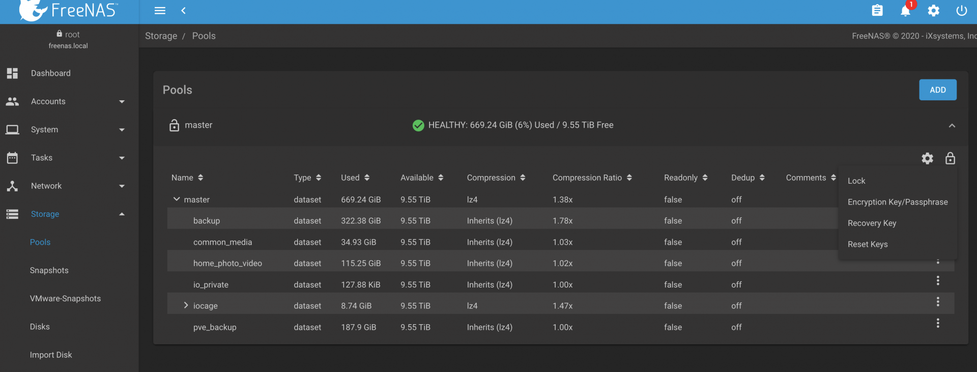

Hello folks.
I've build a home NAS server for FreeNAS some time ago
It was all working alright until I was not playing with is for some months being busy.
There was power outages, NAS went down and now I am trying to bring it back.
It didn't boot on it's own and I forgot how was the boot drive configured.
I tried to boot from a device, supposed to be slog and it aid this is data disk, no OS here.
I was not sure (didn't remember) about the situation with M2-to-USB disk and was wondering if it ever booted successfully, or I am missing some other USB stick.
So I decided maybe I just reinstall FreeNAS on the available 5-th disk (which wa proably an slog device. but I dont remember) and then use my keys to import the pool.
After fresh installation of FreeNAS on the available 5-th disk the OS booted, but I couldn't mount the pool. Some brief googling showed that I may be missing some geli keys, so fresh install was not an option, as I understood.
I decided to find the disk which was supposeed to be the boot one.
Tried to connect the supposed boot disk directly to M2 and it worked.
I have booted my FreeNAS installation as it used to be. I think now I must have all my geli keys in place.
I now see my pool as being locked. Trying to unlock it with a passphrase or a recovery key fails. Below is the log output.
What other details can I provide to sort this issue?
- it has 4 data disks
 - 1 slog device (if I name it correctly)
 - an my boot OS drive is M2 in M2-to-USB case mounter inside internal USB.
 - FreeNAS-11.3-U1
