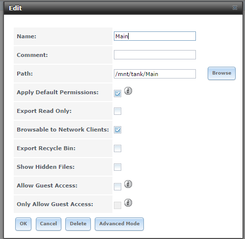

I went ahead and set up the free version just for fun. Worked perfectly. I just logged on as root to test access. My Cifs is exactly the same as yours except. I have no "minimum protocol."
My share and datasets on this box are pretty open and I think pretty much click ok defaults. ;) File permissions are tough to troubleshoot online. I'm not even close to attempting that.
