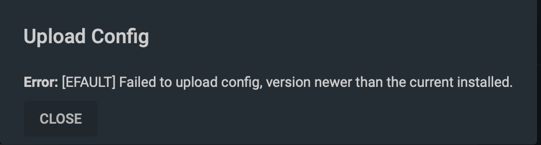

Hi all,
I thought that bug was fixed in BETA2? Is there a workaround? Otherwise I will have to create my entire config from scratch in the UI ... :frown:
Version numbers are identical: FreeBSD truenas.local 12.1-STABLE FreeBSD 12.1-STABLE dee9159d38b(HEAD) TRUENAS amd64
Thanks,
Patrick

Go to /usr/local/lib/python3.8/site-packages/middlewared/plugins, find config.py, and on the else: that does the CallError, do a found = True instead. Then restart middlewared. Obviously not the intent, but it'll get you past this.
So this:
                else:
                    raise CallError(
                        'Failed to upload config, version newer than the '
                        'current installed.'
to this:
                else:
                    found = True
And maybe make sure that a jira bug for it already exists.
