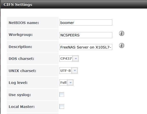

Make sure you have a 'Local Master' (AKA Browser Master) configured on your network; this can be one of your Windows machines or the FreeNAS server. Also, make sure your Workgroup specification on the FreeNAS server matches your Windows network, too. The workgroup setting defaults to 'WORKGROUP' - I use 'NCSPEERS' on my network as you can see below:

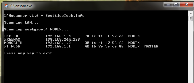

Hi Spearfoot, thanks for your response. Yes I set up the computers and freenas on the same workgroup called "NODEX". And yes, currently my router is the master browser. I used this tool to help me query the workgroup, called "lanscan"
http://scottiestech.info/2009/02/14/how-to-determine-the-master-browser-in-a-windows-workgroup/
I think i see a problem, but i dont know how to fix it: why the heck is my freenas machine not on the same subnet as my other computers? they are all wired to my router, what is going on? it should be 192.168.1.xxx but its this wierd address like 198.105.244.228? what setting is messed up? Thanks

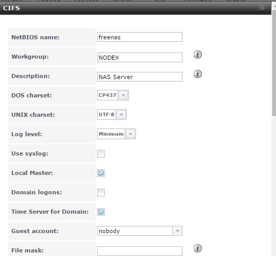

I figured it out guys!
i had a tomato firmware on my ASUS router that was running samba file sharing and had WINS turned on as well. I shut that down made freenas CIFS local master and now the IP subnets match and NETBIOS all resolve. thanks
