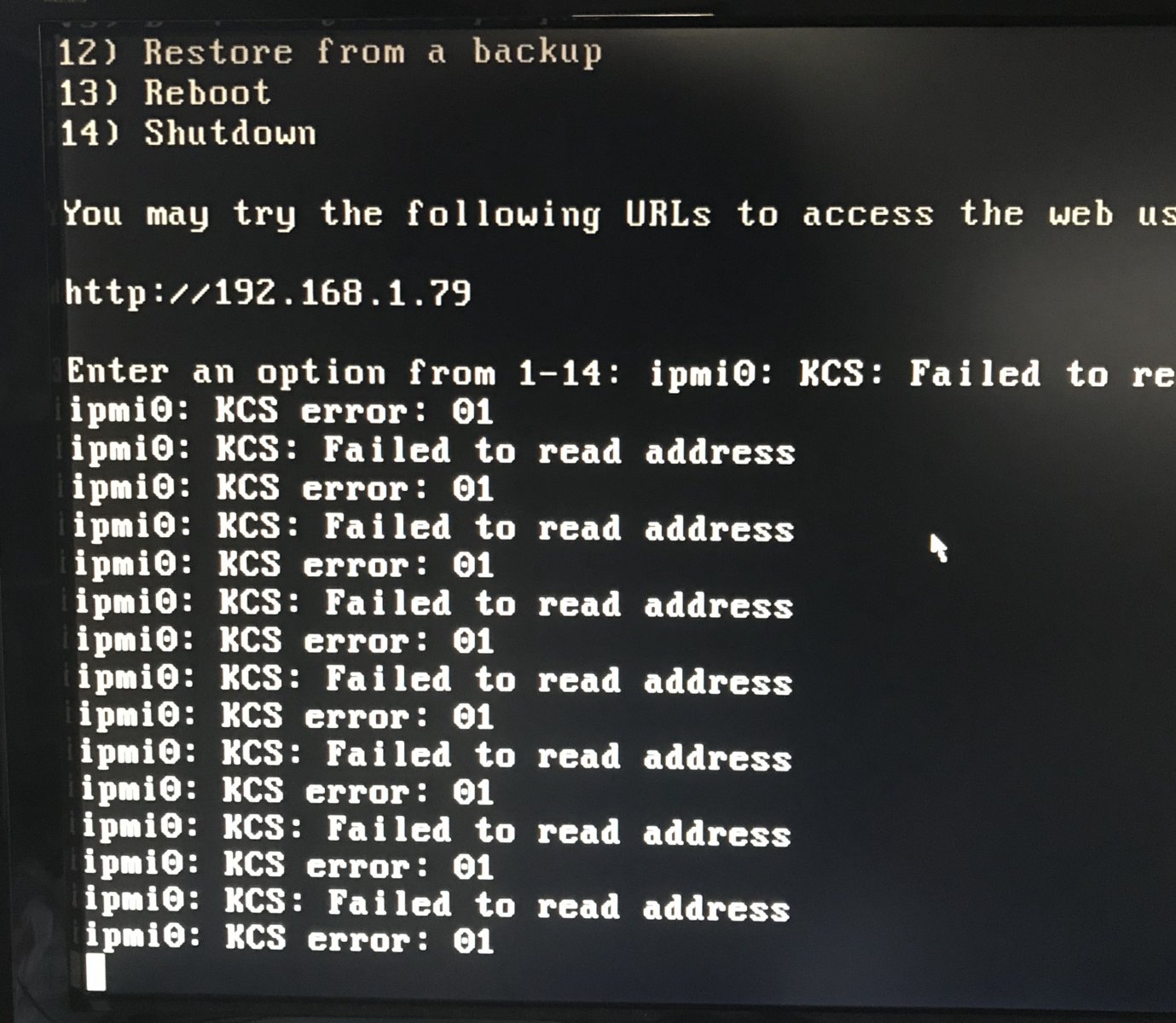

The IP address did change apparently. This is what I see on the console:
15,504
Yep, that will do it. Are you able to log in on that IP address? If so, it would seem that everything's working as intended--though you'd probably want to set up a static IP address on your server.
no, can't seem to access that either.
Pinging 192.168.1.79 with 32 bytes of data:
Reply from 192.168.1.38: Destination host unreachable.
Ping statistics for 192.168.1.79:
Packets: Sent = 4, Received = 4, Lost = 0 (0% loss),
Raheel
Sep 24, 2016
21
That appears to be the computer i am pinging from.
