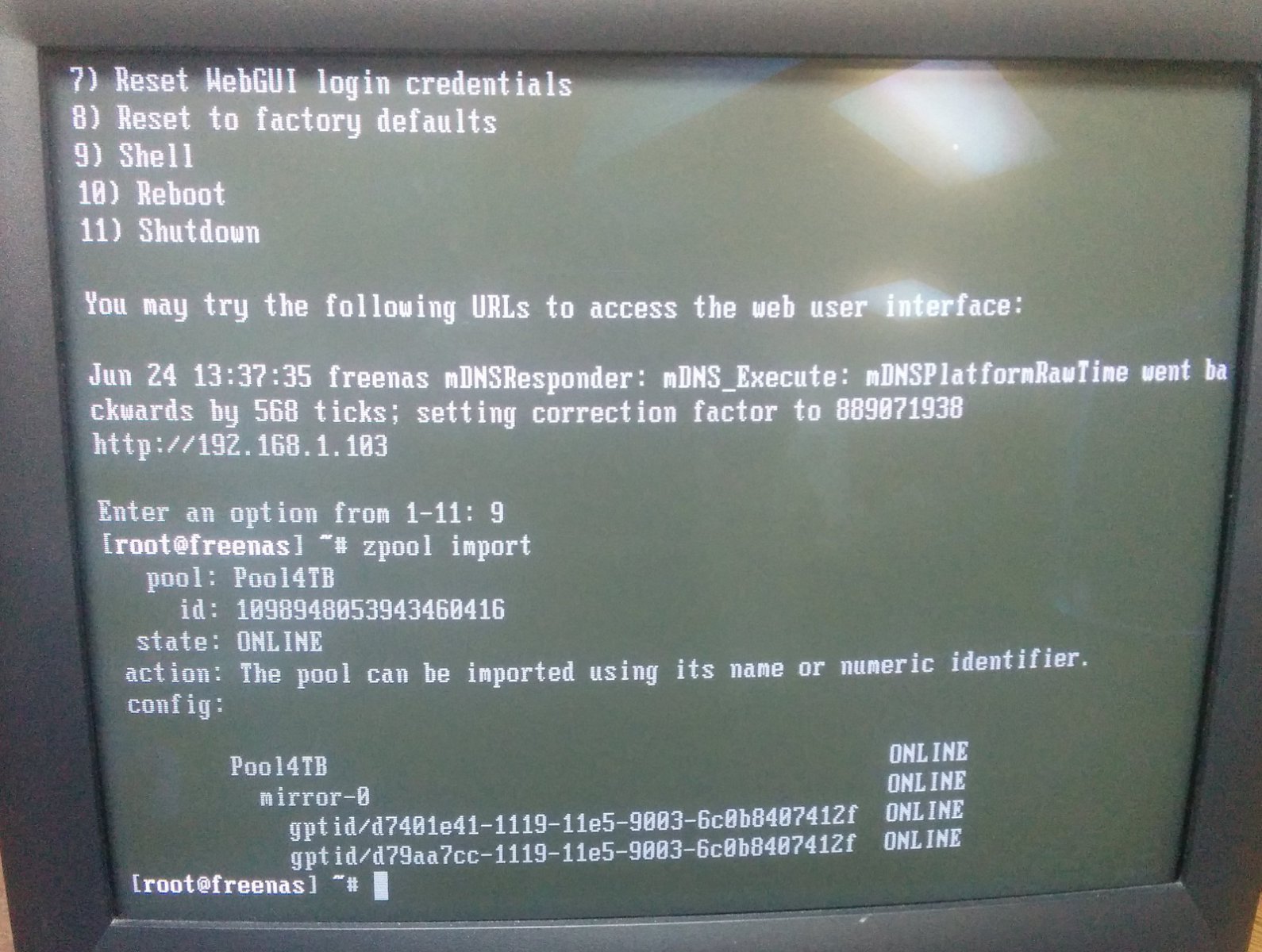

Hi Robert,
I'm ran zpool import from the command line and it appears they're online and importable. I'm having problems uploading the photo to the forum through the forum software, but I have a screenshot here...
http://i.imgur.com/0Yk2aE9.jpg
(pool: Pool4TB
state: ONLINE
action: The pool can be imported using its name or numeric identifier.
config:
Pool4TB ONLINE
mirror-0 ONLINE
gptid/d7401e41-1119-11e5-9003-6c0b8407412f ONLINE
gptid/d79aa7cc-1119-11e5-9003-6c0b8407412f ONLINE
[root@freenas] ~#)
When I originally created the pool, I had disabled hardware raid controller and setup software NAS mirror via raid-1 when I made the volume.

Noctris
Jul 3, 2013
163
try
zpool import -f Pool4TB
And indeed.. 4GB is definately low on ram but that will be solved soon i see ;-)

NAS27
Jun 19, 2015
7
I tried zpool import -f Pool4TB and a ton of text rapidly scrolled up the screen. Then the unit rebooted. I logged into the web console and the volumes didn't import. It appears to be the same situation as the auto-import.
I'll try again after I get the RAM on Tuesday.
