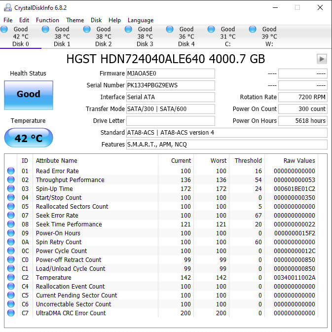

All drives are in good health:
9,700

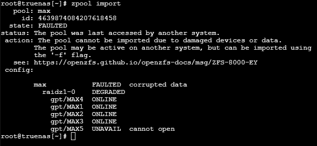

The instruction is there in the output...
zpool import -f max should do it, but with the data corruption mentioned, it may be necessary to use -F. Without your parity, you may be unable to recover the pool with the combination of corruption and a missing disk... one of the reasons the forum strongly recommends RAIDZ2.
zpool export max and then import it with the GUI again if you want it back to normal after a successful manual import at CLI.

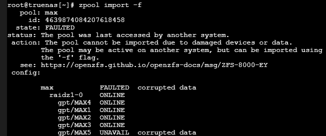

Thank you so much. Thing is that I changed also ther host machine, I don't have access to it, only disks remained. So on the new machine I:
zpool import -f max
I think volumes MAX1-MAX4 still contain my data, only MAX5 needs to be replaced for redundancy.

Well, first of all, it seems you didn't use the command I suggested. You left off the pool name, so we don't know if it would work or not.
9,700
So, that's telling you there's at least one of the remaining disks that isn't behaving correctly, leaving you unable to get the pool to import.
You can perhaps try with -F instead, although I haven't seen many cases where that will work.
Beyond that, you're left with the suggestion of the output... destroy and re-create the pool from backup (or if you don't have a backup and/or are desperate to get files back from the pool... Klennet... you'll need a Windows machine and if you are really worried about the data, a dd copy of each disk to work on, then you can see what might be recovered... and decide if you want to pay... it's not cheap, so you'll have to decide).
