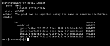

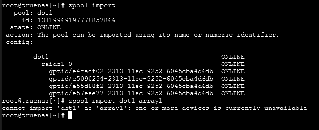

Good afternoon, after a memory problem on my MOBO, the pool appeared Offline, in an attempt to import again it gave the following message:
('one or more devices is currently unavailable',)

the pool is in raid-z with 4 disks of 1 Tb, the only different thing that happened was that during the boot, the mobo chose one of the disks in the pool to boot, but then I restarted and changed the boot order to the correct one.
Has anyone had a similar problem?
Thanks
