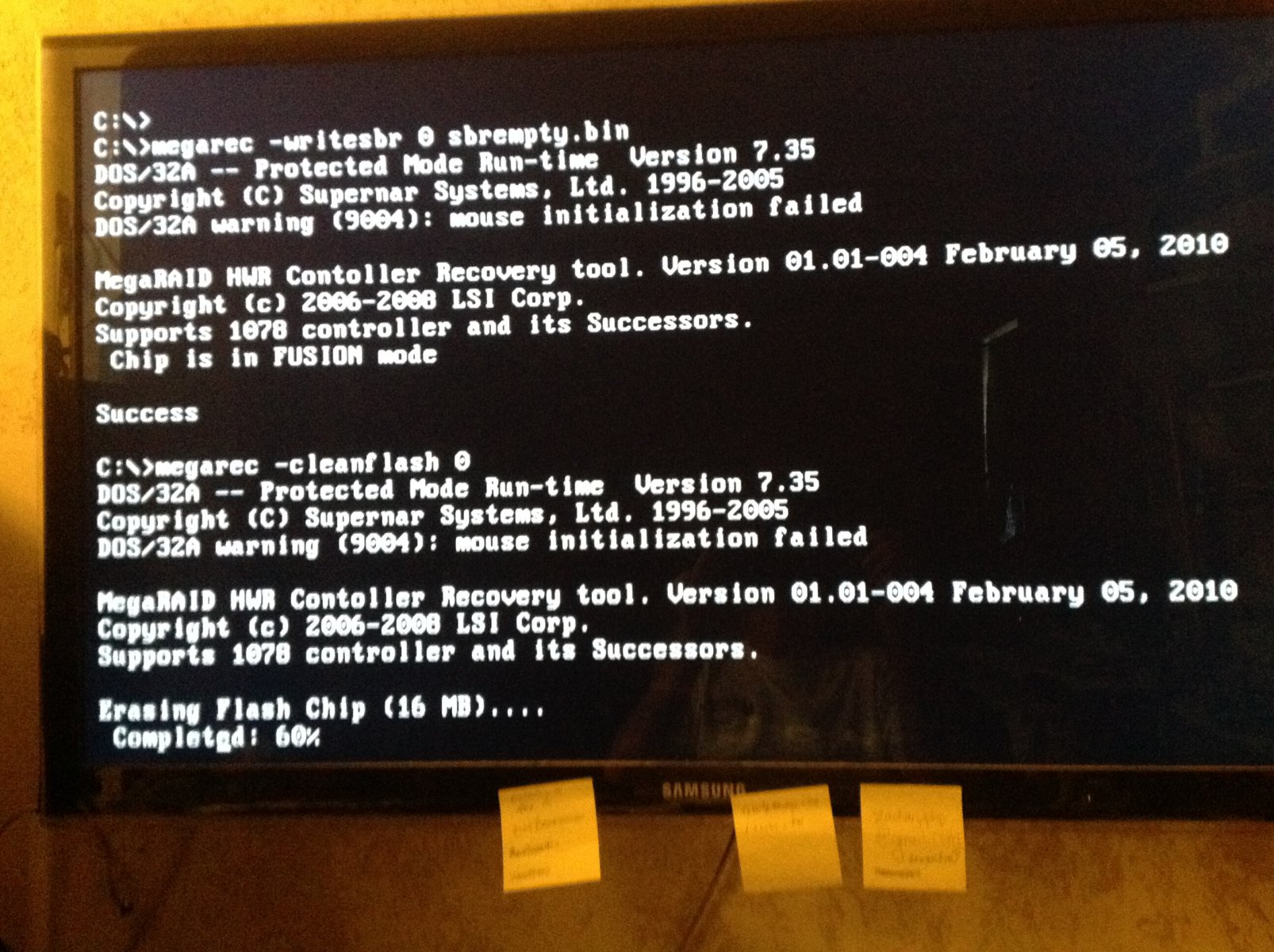

You must use the LSI Megarec.exe to first wipe the existing firmware,
I assume your try to crossflash a m1015 card?
The megarec exe file needs to be on the drive and iirc
the command is <megarec -cleanflash 0>
OR perhaps it's <megarec -writesbr 0 sbrempty.bin>
I can't remember exactly, but you have to wipe the IR firmware BEFORE you change over
to IT and flash the new bin file...
Stand by and I'll try and find the servethehome.com link for you...

I found this picture I took of my computer screen when flashing my RAID card
