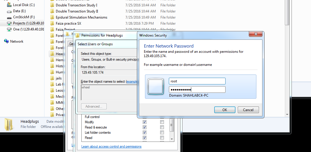

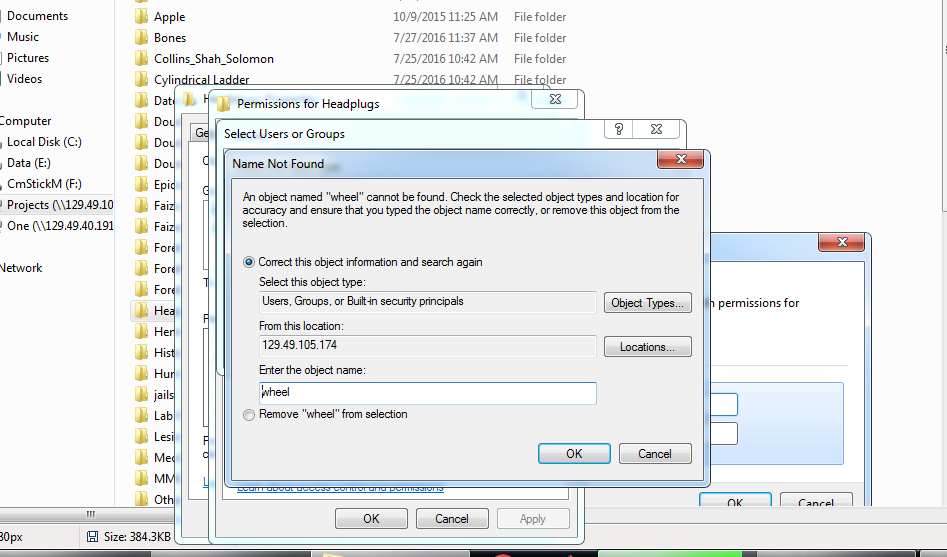

For about a year I've been using the server with multiple users/groups/datasets. I would always set the permissions in windows. I would connect to my share, and use properties>security to edit access to folders. However, recently after rebooting the server, when I try to edit permissions, it will ask me for someone with admin rights on the server to login with (even if I already am logged in as root), as such I will put in root credentials. Once doing so, when I then search a user or group that exists, it will tell me that it cannot be found at the server address. Therefore, I cannot edit user permissions anymore.

Hi Monkey, I wish it were that simple. The thing is I cannot access my user or group list via windows explorer when trying to set permissions there. When I search for them, it says they do not exist. This is with the dataset's permissions being set to windows.
Rhombus12
Jul 28, 2016
5

Setting permissions can be a bit of a "chicken and egg" problem. The user you're authenticated as needs to have permissions in order to set permissions. It doesn't look like you have them.
