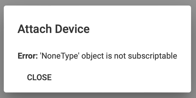

Upgraded from 12.x to 13.0 and figured it might be wise to add a mirror USB stick to my boot pool.
Having seen issues with not using the same make/size/brand I got a second Samsung Cruze 32GB to match the original. However following the steps to Attach. after a pause I get the error above

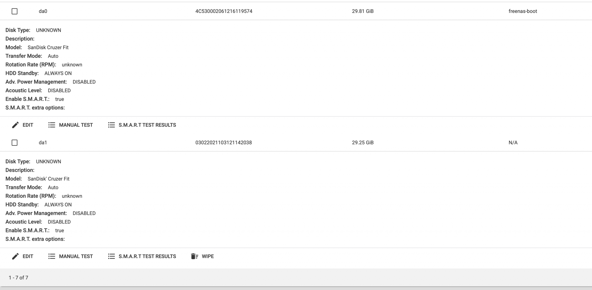

I also tried going into the Disks option and Wipe for the newly added drive.Still same message.
Here are the details from the boot pool and storage for the two relevant drives. Is this a known issue in 13 or is there a workaround besides doing a reinstall against each USB stick ?

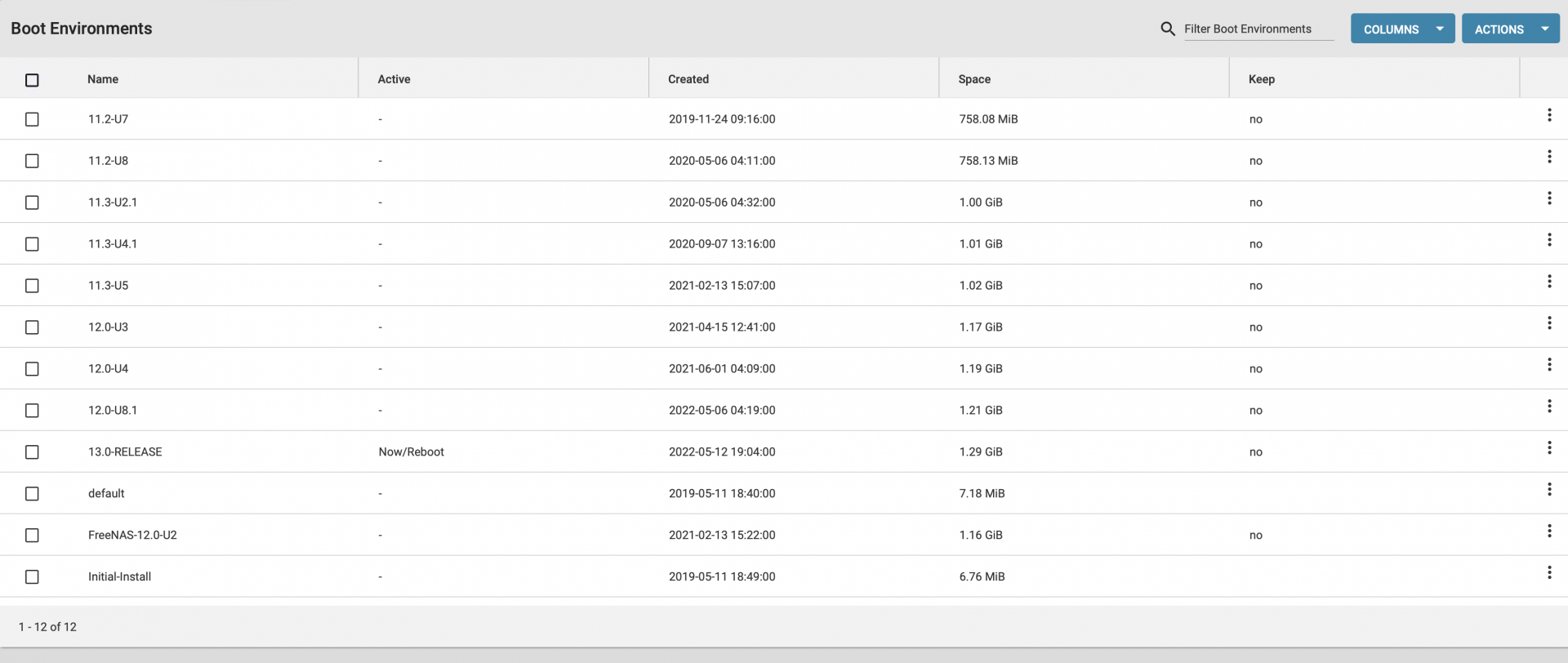

well .. aside from the fact that USB drives are not recommended for booting from anymore .. maybe delete your 1st 7 boot environments from your drive and then try mirroring it again ... 12.0-U8.1 was stable, so you don't need the rest.
