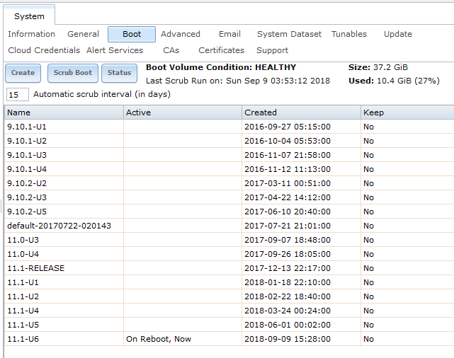

I was a little off about the usage percentage. Still, only about 10 GB used and I have all my boot environments back to 2016.
I realize you are only using a 16 GB module, but there must be a configuration problem causing it to fill up the boot drive.

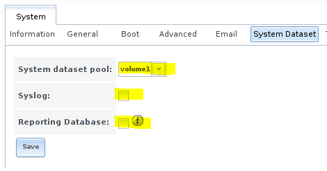

Since you are reinstalling, you might correct the problem, but my concern is that it will continue in future. You may have had the system dataset on the boot pool. This is a thing that changed (I can't remember when) but it might be the cause of the problem.
Here is the section of the documentation:
http://doc.freenas.org/11/system.html#system-dataset
You need to make sure the dataset pool is set to the storage pool and the syslog and reporting database too. Those things are constantly writing and will wear out a USB drive in no time and might account for how full the drive was.

I had boot environments from 2015 on mine. But still - totally valid, and appreciated. I looked, and my system dataset and syslog were both on my actual data pool (not the flash drives). Reporting database wasn't, however, so I could change that.
