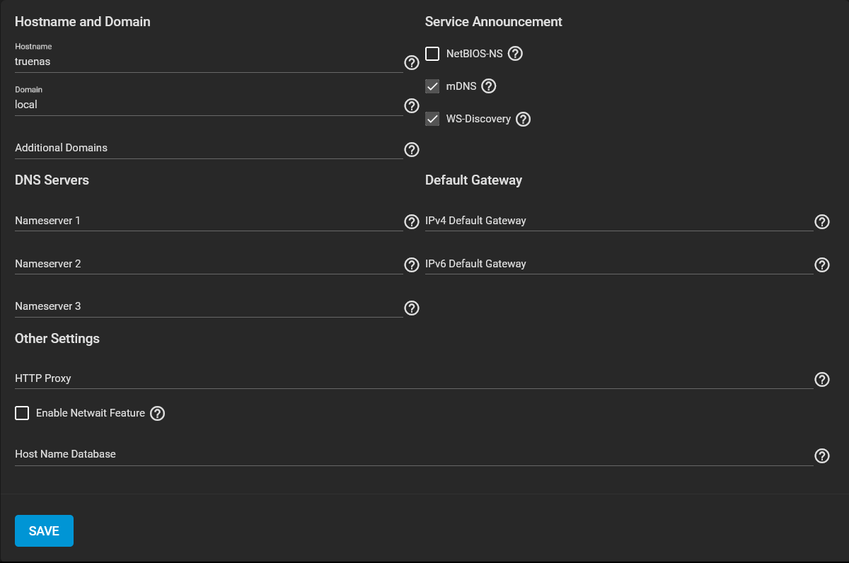

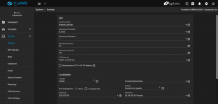

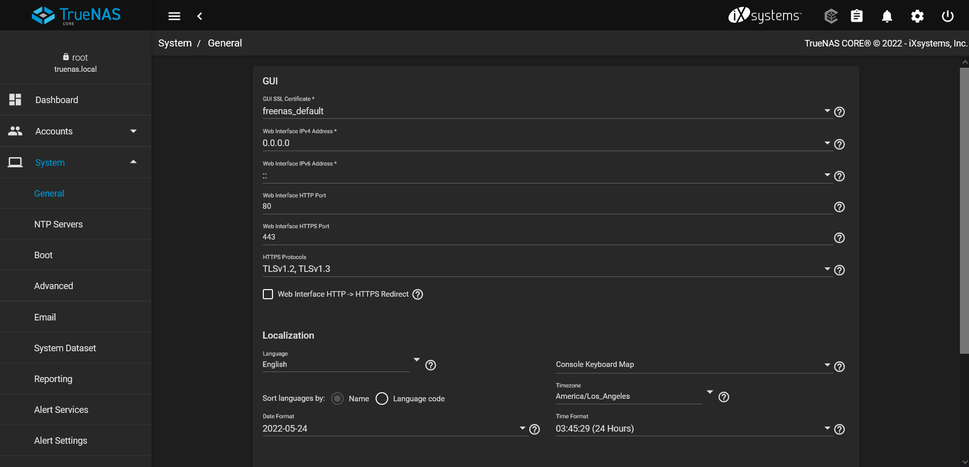

I attached my General page as a screenshot.

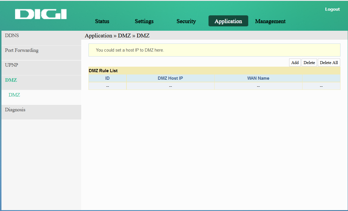

Are you sure you're not connecting your TrueNAS server to a port on your switch (or using an IP address) that's designated as DMZ? Or some kind of VLAN setup?
I can't see anything that points to any kind of restrictions that wouldn't be coming from the router in some way.

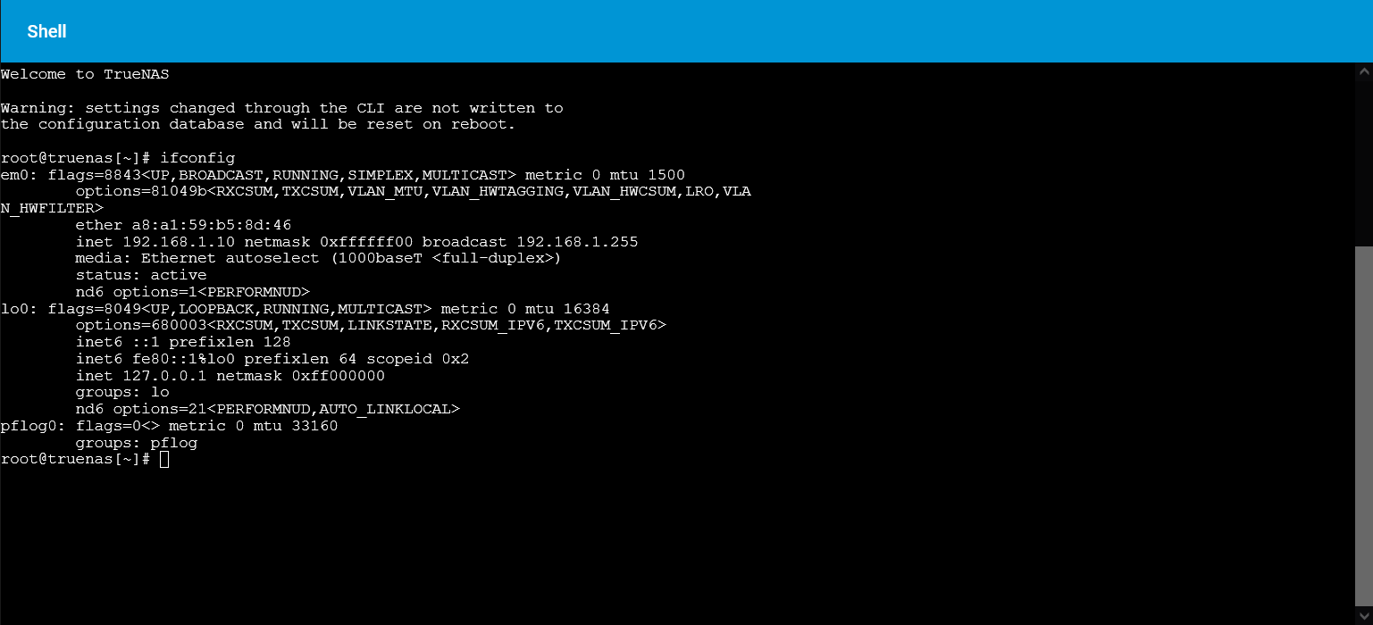

Log into your NAS via SSH and post the output of ifconfig in code tags.
I dont know how to use SSH, but i think this is what you were asking

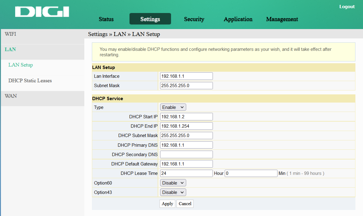

this is the DMZ tab in my router, and i could not find VLAN options, only WLAN, but as far as i know, its 2 different things

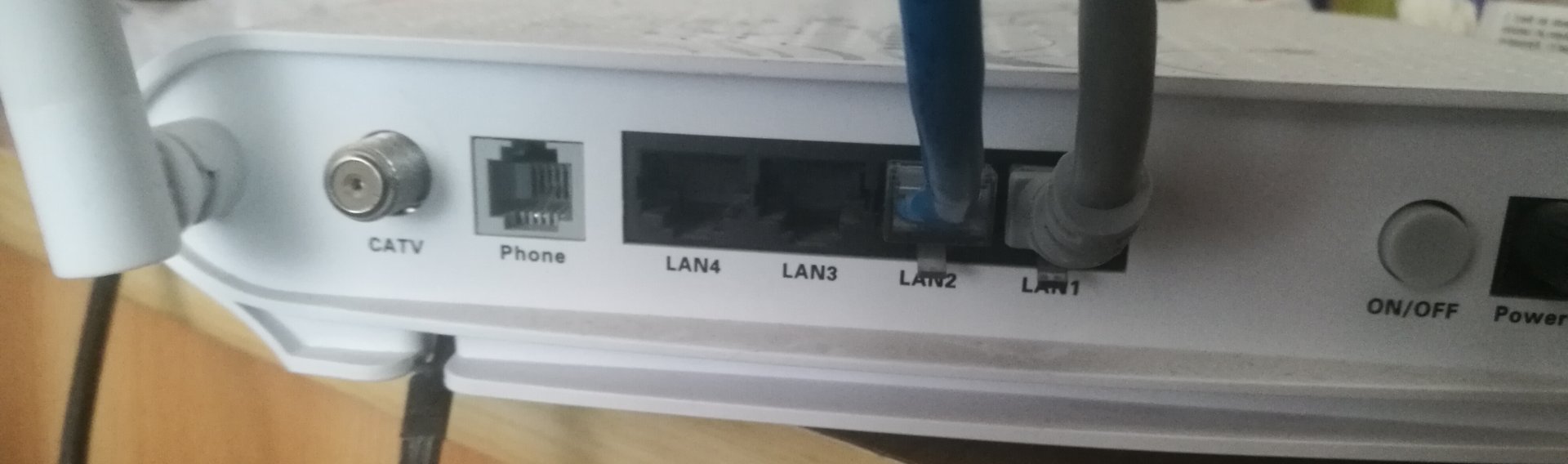

As for ports, there are only 4 ports marked LAN on my router, and both my laptop and the TrueNAS pc is plugged into those

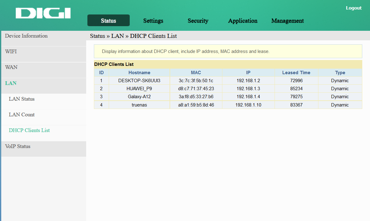

OK, does the router have anything on the LAN ports? (Maybe under Settings or Management)
Also, what's the IP address of your PC? is it in the same subnet range? 192.168.1.x ?

it is in the same subnet range
also in the management tab, all you can do is restart and factory reset the router (but factory resetting is not an option since if i do that, the ISP has to send out someone to configure the login details to their servers, so that leaves me without internet for about a month)
Also the Firewall and UPNP are both disabled, i dont know if those are of any significanse

Do you have your default gateway defined in Network>Global Configuration?
Jony
May 23, 2022
14
well i dont think so, but heres the picture
Also to clear some things up, after installing i literally changed nothing in TrueNAS, everything is on its default setting, I dont even know what half of these things do, so i just didnt touch them.

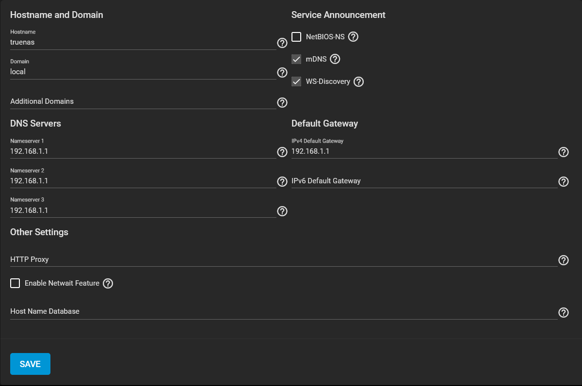

Please put in your gateway address - 192.168.1.1 - in the 3 nameserver fields and the IPv4 Default Gateway Field and Save. Reboot and you should be able to get to the GUI at your assigned address of 192.168.1.10.

I hope I understood correctly, i think this is what you asked for. But sadly, i still get timed out, if i try 192.168.1.10
