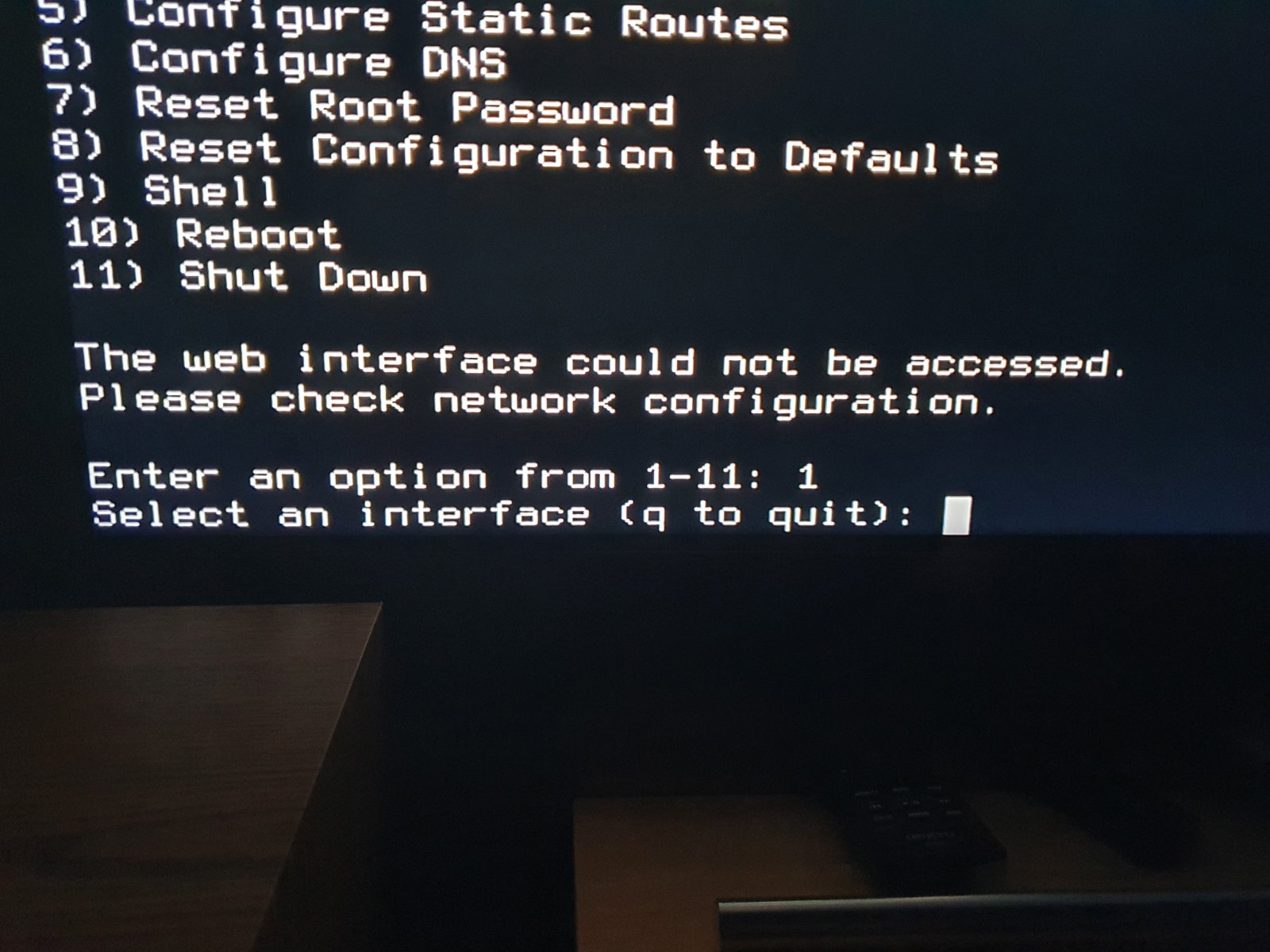

Hello,
after installing FreeNAS I have the error:
the web interface could not be accessed
Please check network configuration
The NAS is not visible on my network.
Many thanks for your help

Most likely reason is "unsuppported hardware". Please give us motherboard, NIC, FreeNAS version, and then some guidance can be given.
Under Option 1, do you see your network card?

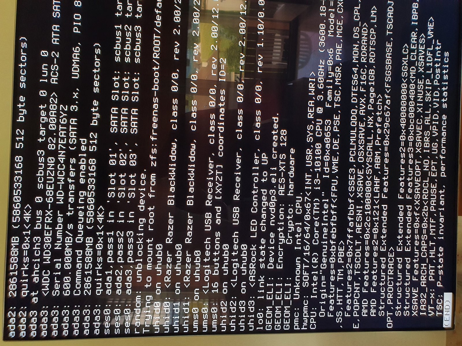

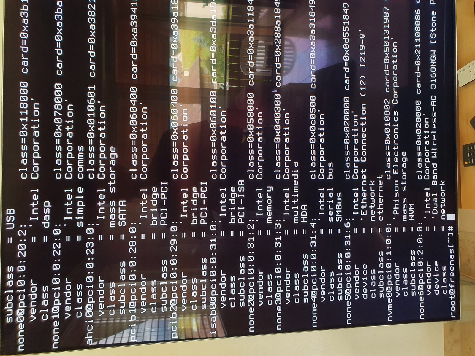

You should be able to go into shell and dmesg | less and see what's going on with the Intel drivers for that I219V NIC. You'll also want to see that pciconf -lv shows you the NIC inside FreeBSD. If it's not there, the driver can't bind to it.
Yorick
Nov 4, 2018
1,912

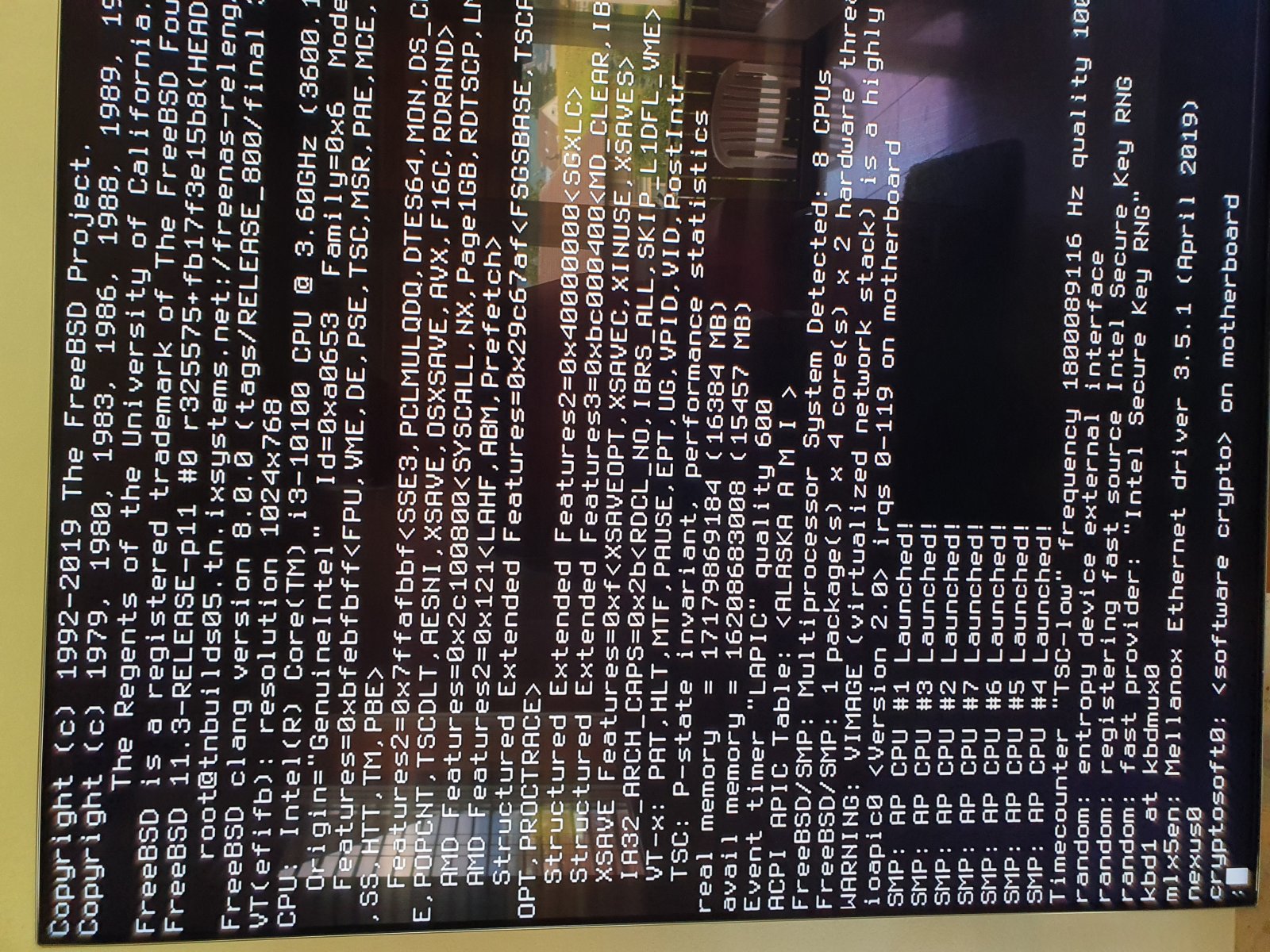

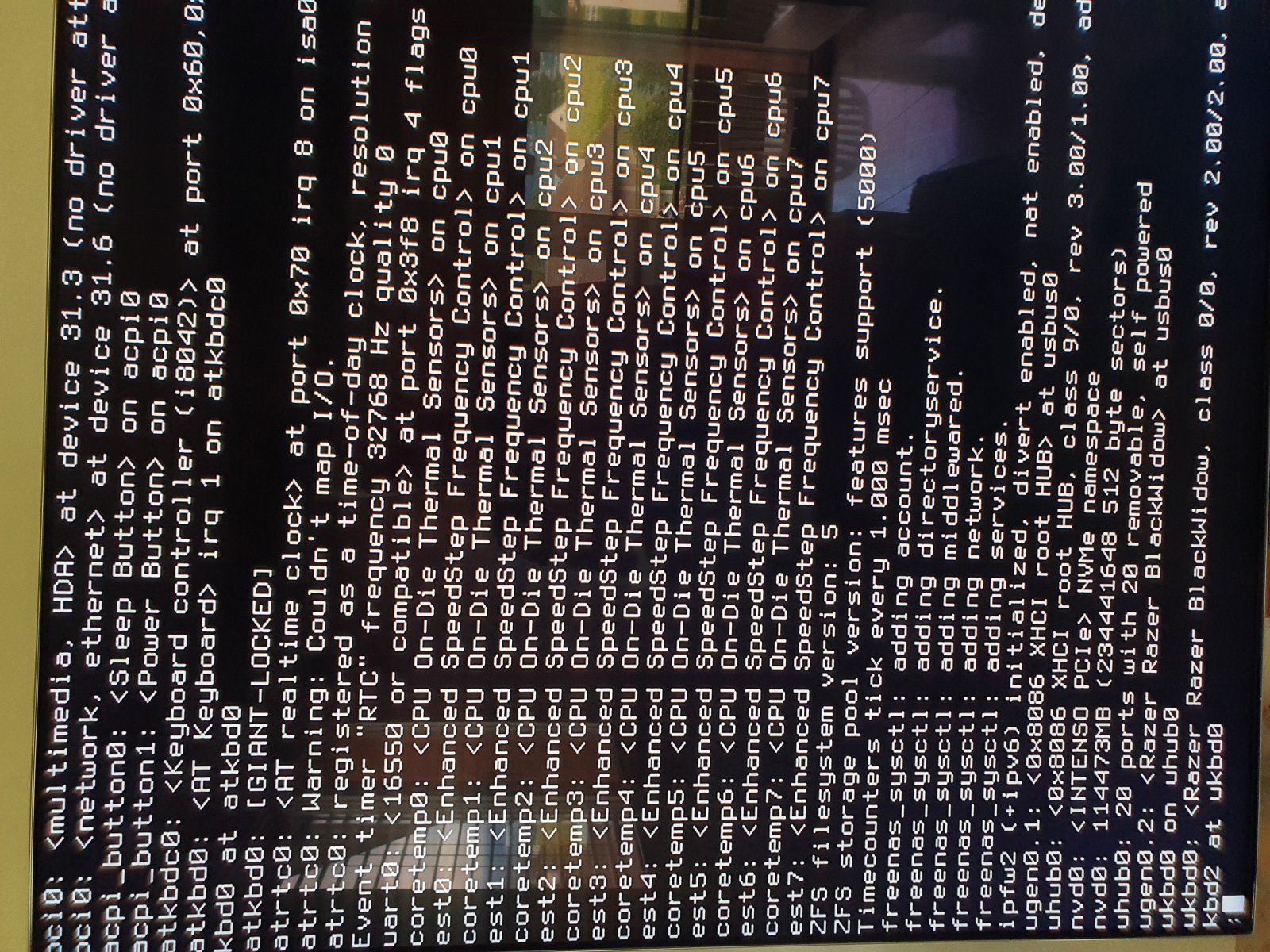

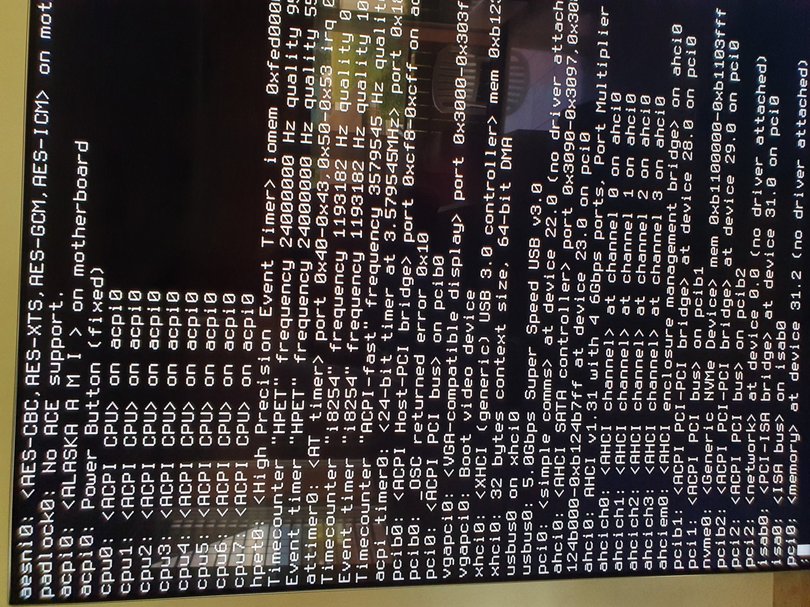

Well the i219V is there. In your dmesg, I don't see the relevant portion about Intel, did you actually scroll to the part where the Intel Ethernet driver tries to load? man less will teach you how to use it. In a nutshell, SPACE goes forward, b goes back, q quits, and / searches.
owegen
Aug 12, 2020
37

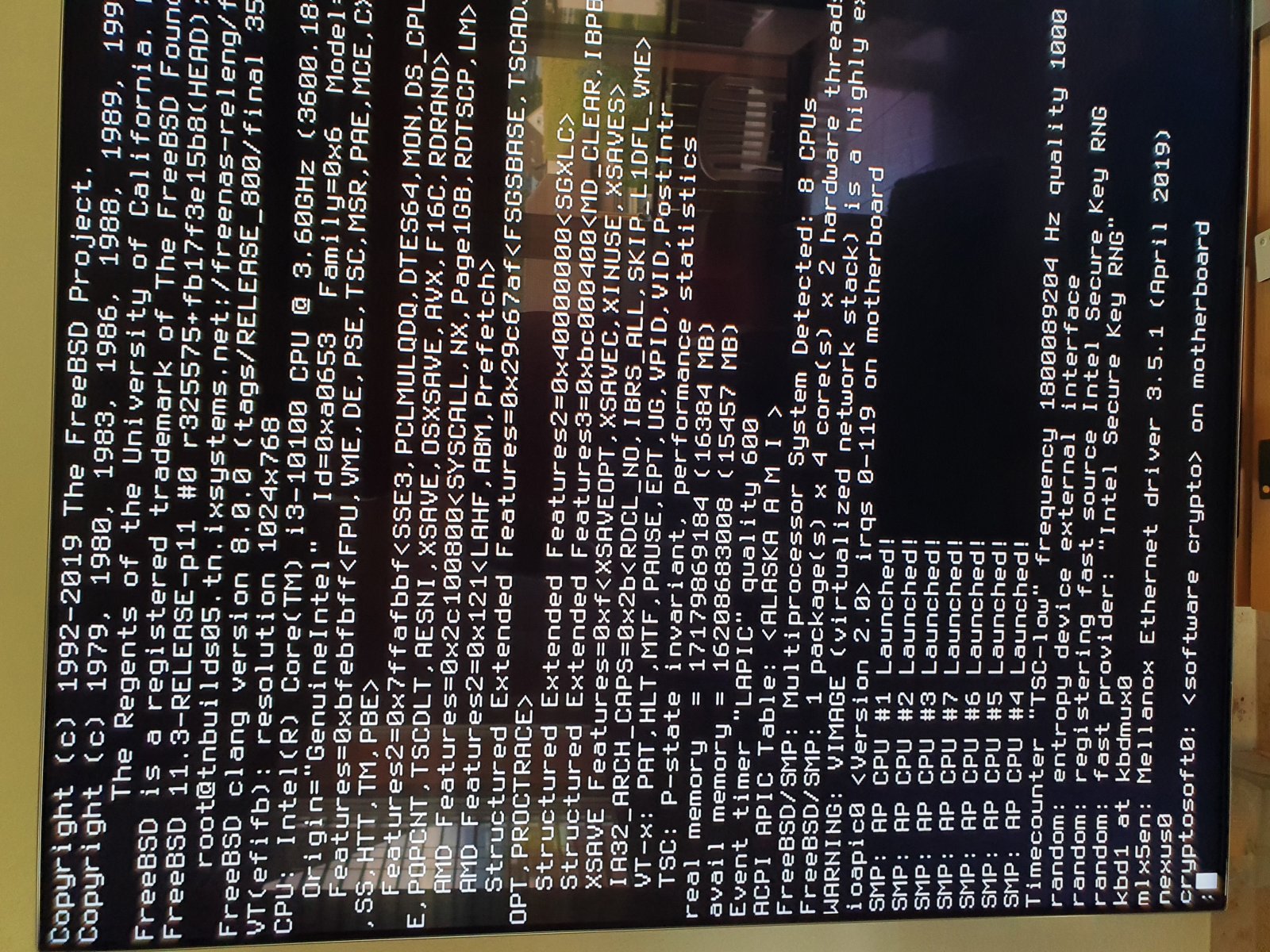

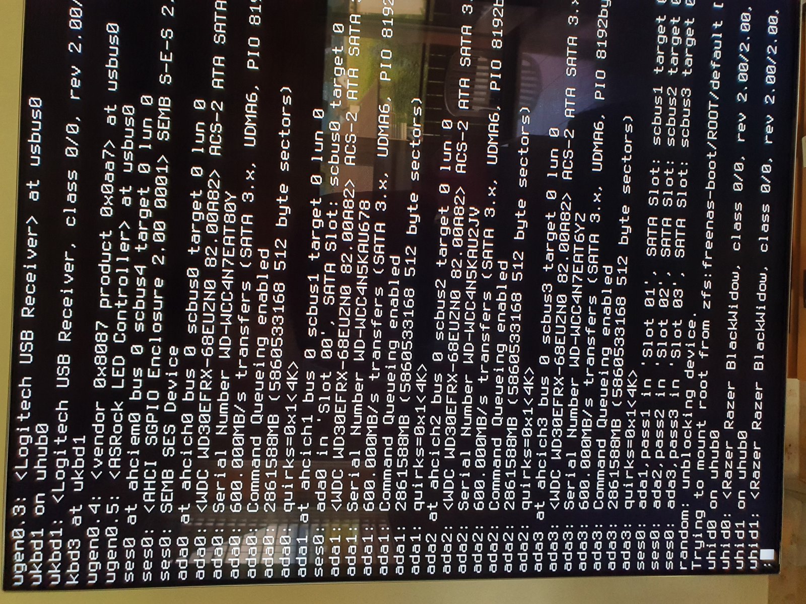

many thanks for your instructions!
This time I send you all pages I became. I hope it helps

“No driver attached” in dmesg for 31.6 which is your Intel NIC. Highly unfortunate.
Fiddling with addon drivers is tricky. Doable but tricky. I’ll suggest to side-step the issue by buying an i210 Intel NIC on eBay, they are around 20 bucks, or maybe one of the server intel nics on eBay, around the same cost. You can use that to get up and running and then take your time to find out what’s going on with the FreeBSD drivers for i219v.
