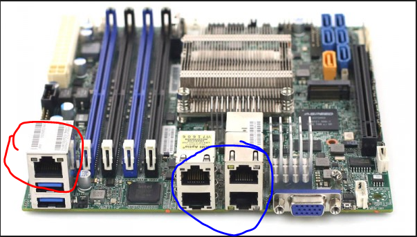

It sounds to me like you have connected your network at the plug circled in red. That is the IPMI only interface. It does not connect to the rest of the system, only to the IPMI remote control feature. The connections circled in blue are the ones for normal network connectivity and you can use one to red and another to blue, no problem, it is like connecting to two different computers.

I'm actually connected to one of the blue ones (bottom left on the picture at the moment which seems to correspond to igb0)

I realized that I hadn't really tried the other 3 ports:
- The two rightmost ones (which I think correspond to the faster ports) do nothing (ifconfig shows no information, and the lights on the port do not go on)
- The one above the one I used before (igb1) behaves like igb0: lights go on and I can reach it via ping, but the console setup screen shows "the web interface could not be accessed.
Extra bit of information: I see "unknown dhcp option value 0x7d freenas" come by from time to time during boot
